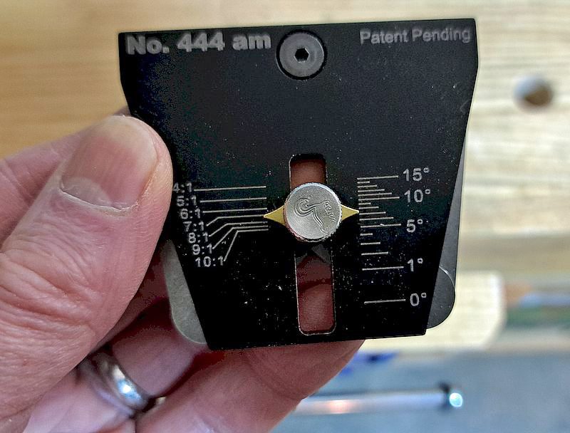

Easy to read scale

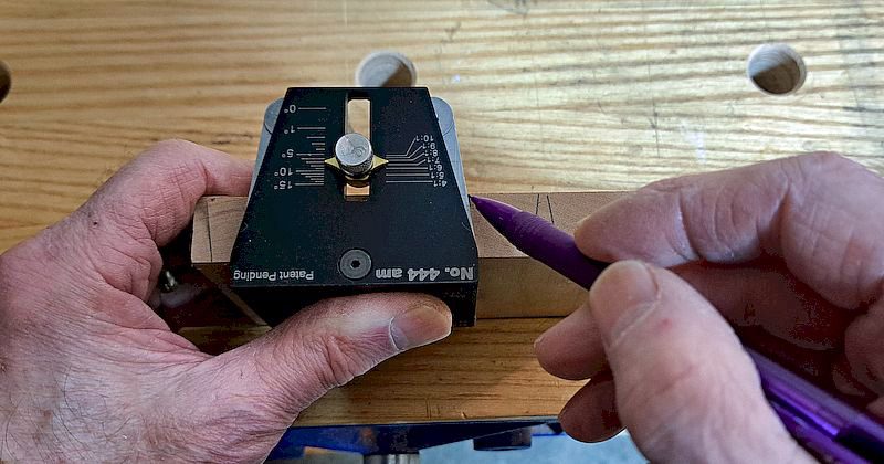

Set the angle and mark one side of the tail

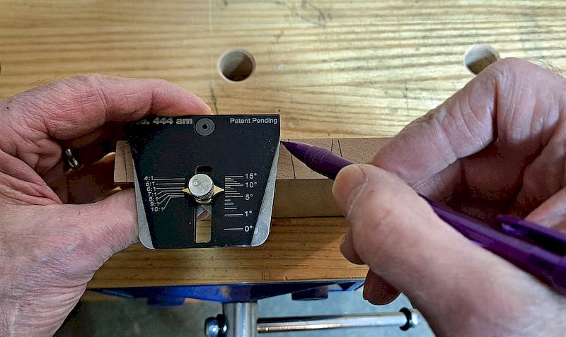

Flip it over to mark the corresponding angle

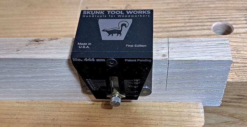

Use it as a saddle square!
