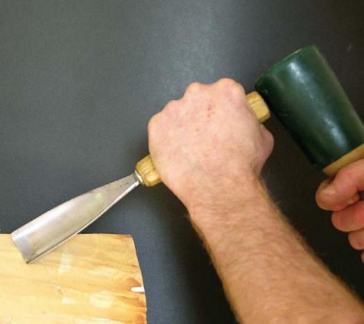

To use a mallet safely, it is essential that the carver grip the gouge properly while striking it with the mallet. It might seem logical to grasp the handle of the gouge; however, when the cutting edge of the gouge passes through the wood, the force of the mallet blow can drive the gouge through your fingers and onto the floor. To prevent such loss of control, the gouge shank should be grasped (i.e. between the handle and the cutting edge). This technique provides maximum control of the cutting edge and prevents the gouge being driven from one’s grasp.

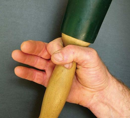

Many carvers are discouraged from using a mallet because it is thought to be hard work. With a mallet weighted to your individual preference, this expectation could not be further from the truth. In addition, most people grip a mallet too firmly. (In fact, the prolonged squeezing of the handle, not the striking, is the cause of tennis elbow.) A good mallet has a slightly narrower neck where the handle joins the head. To avoid squeezing, the carver should grasp the handle lightly with the thumb and forefinger encircling that neck. When striking with the mallet, the head can be accelerated with a flick of the wrist thus achieving much greater striking force with less effort. With a little practice, a carver using this technique can work effortlessly for extended periods.

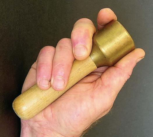

Not all mallets are intended for bulk wood removal. A detail mallet is generally much smaller than a standard woodworker’s mallet, and is usually made of a heavy material to provide adequate striking power. The one I use has a brass head. It would be more reasonable to describe the use of a detail mallet as ‘tapping’ rather than ‘hitting’ or ‘striking’. To provide the necessary accurate control, one should hold the gouge near the cutting edge as if working by hand alone. The detail mallet is held with the handle in the palm and the head of the mallet between thumb and fingers and tapped against the butt of the gouge handle.

WRONG way to hold gouge ✕
RIGHT way to hold gouge ✓
A good mallet has a narrow neck
Hold neck with thumb and forefinger
Cradle detail gouge in your palm
