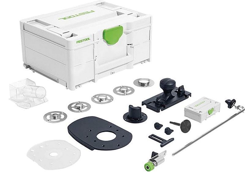

The OF 1010 comes in three flavours. There is the base model (photo above) and for an additional $270, you can purchase the base model bundled with the accessory kit (#578307), sav­ing $155 compared to buying the kit separately. A third option bundles both with a 32″ guide rail (#578308). These accessories significantly enhance the router’s functionality, making the accessory kit — in my opinion — indispensable.

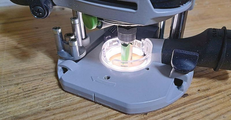

LED Ring Light – If you’ve ever tried to use a router to perform accurate work, you’ll know how helpful an LED ring light can be. It will not only shine a light on the immediate work area, but it will eliminate shadows.
A standout addition is the LED light ring mounted on the base. It provides excellent illumination of the work area, elimi­nating shadows, which is particularly helpful for detail work. For someone with aging eyes, I’ve found it invaluable for seeing fine cuts more clearly. I leave it attached permanently, but it’s quick to remove if you need to. You get up to six hours of use and it has a 15-minute auto power-off feature. Recharging is via a USB-C cable (user-supplied).

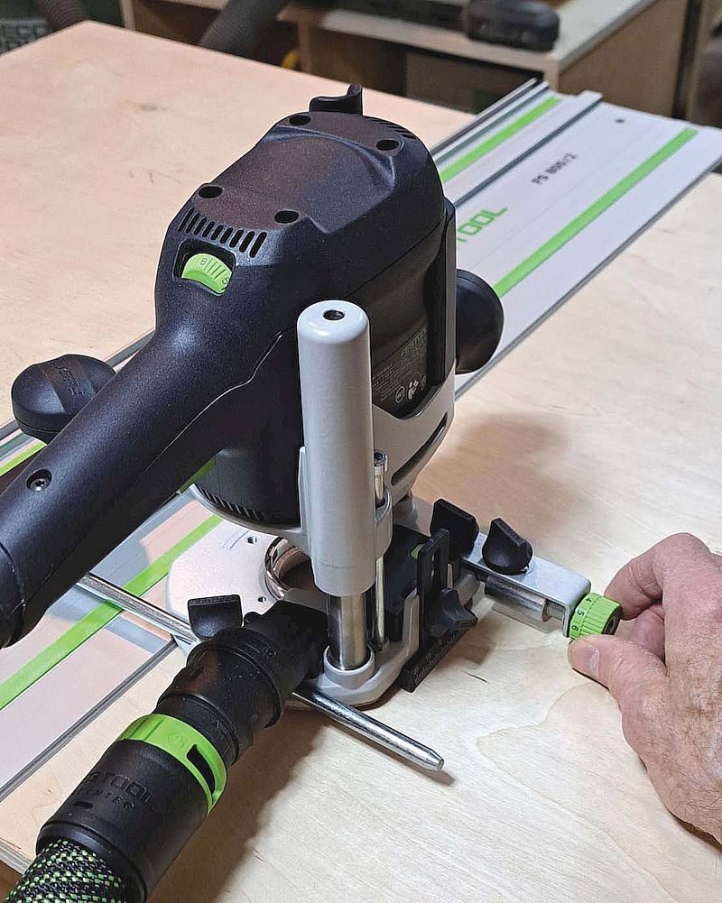

Guide Rail – The guide rail and guide rail adaptor adaptor increase the functionality and efficiency of the OF 1010.

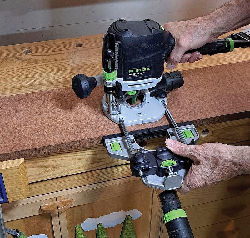

The updated OF 1010 replaces the guide rail adapter with the redesigned parallel edge guide, which I think is a good choice — at least for me, as I use the edge guide much more frequently (the guide rail adapter is now bundled in the accessory kit). Using the two supplied guide rods, you can rout grooves up to 3-1/4″ from an edge.
Parallel Edge Guide – The redesigned parallel edge guide with micro-adjuster allows precise fine-tuning of the bit’s distance from the edge of the workpiece. Used with a dust extractor, the clear extraction hood captures virtually all the dust for cleaner operation.
But what sets it apart is the micro-adjuster, allowing precise positioning in 0.1 mm (0.004″) increments. The edge guide is quick to attach and remove and remains stable in use. Also included is a guide bushing adapter that adds greater versatility by allowing you to use standard guide bushings with this router. It’s an essential accessory that I use a lot.
Accurate Adjustments – When using the guide rail, the micro-adjuster allows precise positioning in 0.1 mm (0.004″) increments.

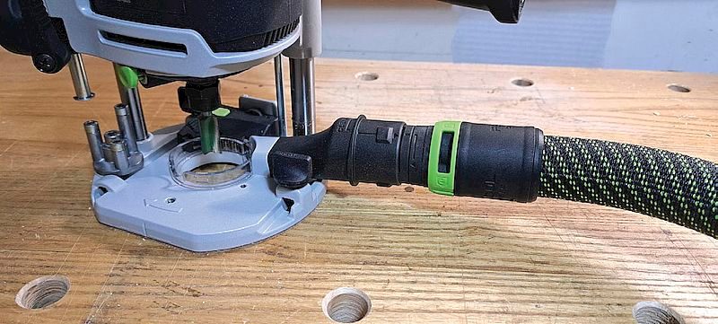

When paired with a Festool dust extractor, the OF 1010 is very efficient. I estimate that a good 80 percent of the chips and fine dust are removed without the use of any other dust reduction accessories. The chip collector, which does an excellent job divert­ing chips to the extractor connector when edge routing, no longer comes with the upgraded OF 1010 — it’s been moved to the acces­sory kit. Another reason to purchase the kit is the extraction hood that attaches to the parallel edge guide — it greatly contributes to near dust-free routing. The extraction hood is by far the best dust shroud I’ve ever used. Another accessory in the accessory kit worth mentioning is the trammel unit that enables you to rout arcs and circles just under 30″ in diameter.
Great Dust Control – Festool is known for superior dust control, and the setup on this plunge router is no different. When attached to a Festool dust extractor, airborne dust is eliminated almost entirely.

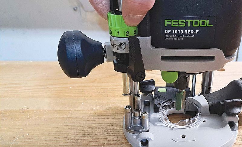

The OF 1010 strikes an ideal balance between power and maneu­verability, especially for detailed work. Weighing just over 7 pounds (3.2 kg), it’s easy to handle and well-suited for intricate routing tasks. The smooth-action plunge mechanism is excellent for mortis­ing, inlays and controlled depth routing. A fine adjustment wheel lets you dial in bit depth with 0.1 mm accuracy — an outstanding feature for precision joinery.
Micro Depth Adjustment – The Festool OF 1010 is equipped with a standard depth adjustment dial that allows the user to dial in bit depth with 0.1 mm accuracy.
The router delivers a plunge depth of 2-1/8″ (55 mm), enough for most tasks. It’s powered by a 1010-watt motor with a no-load speed range of 9,500 to 23,000 RPM. Soft start and constant speed under load contribute to a smoother, more stable routing experience.

Accessories – The Accessory Kit enhances the Festool OF 1010’s versatility, providing essential attachments for precision, control and efficient routing tasks.
