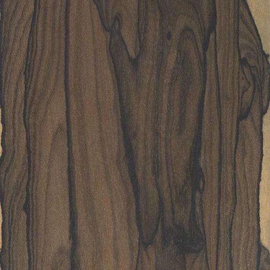

There is no shortage of beautiful woods available to the craftsmen, but, there is one species which has a flare for the dramatic and that species is Ziricote.
There is no shortage of beautiful woods available to the craftsmen, but, there is one species which has a flare for the dramatic and that species is Ziricote. Its brown to grey heartwood is overlaid with black lines giving it the appearance of a busy spider web. Other pieces will have a ‘landscape’ figure, with images of mountains, valleys, clouds and marble like patterns. Add in a contrasting creamy yellow sapwood and you have a wood that captures the eye and the imagination.
