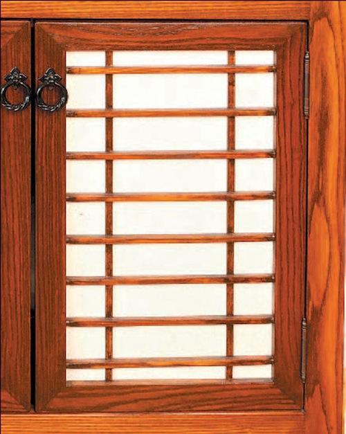

The end frame is typical frame and panel construction, but the risers are a bit different. The frames for the risers are machined the same way as the end frame, but in place of the panels are wooden kumikos. These horizontal and vertical wooden members join each other with a lap joint. A notch is machined into the frame to accept each kumiko. The horizontal kumikos are 3/8″ x 3/8″, while the vertical kumikos are 3/8″ wide but only 3/16″ deep. Since the vertical members are half the thickness, I cut lap joints in the horizontal members only – simplified construction and the addition of an interesting visual element.

The frame now machined and assembled, I take the dimensions for the two doors. I like to machine and assemble the doors so they just barely fit into the space then trim the doors according to the specific size and angle requirements. This takes a bit longer to do but the result is doors that fit perfectly. I also machined and installed an interior side frame on the left side of the centre cupboard to divide this area from the small drawer.
The mitred door construction is very similar to most doors, the two differences being the rabbet cut on the inside edge and the notches to receive the kumikos. The rabbets and kumikos are necessary for securing the paper. I had to keep the risers in mind while machining notches for the kumikos on the doors, wanting their proportions to be similar.

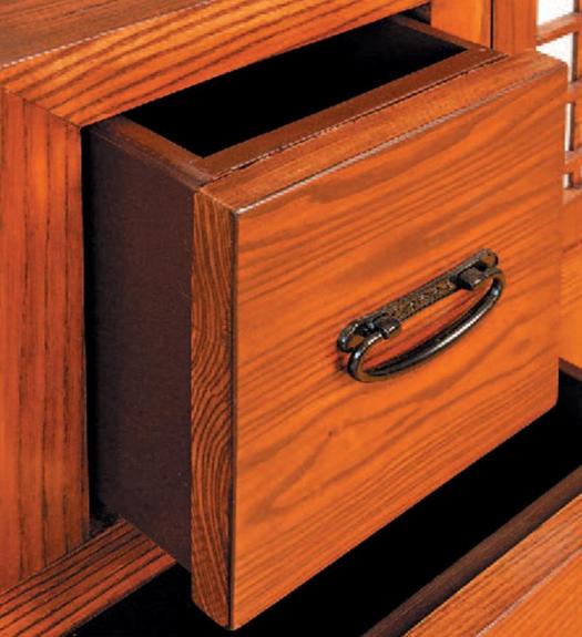

I attached the hardwood drawer slides and constructed drawer boxes to match. The slides are 1-1/4″ x 1-1/4″ solid with a 1/2″ rabbet to accept the drawer. I use wooden slides because they are long lasting and when well built, provide years of smooth and easy use. Solid ash slab drawer fronts are machined and attached to the drawer boxes.

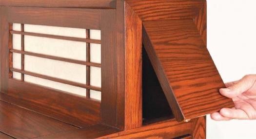

At the bottom of the secret compartment, ash cleats are placed on either side of the opening directly behind the face frame. Rare-earth magnets with steel cups and washers – (from Lee Valley), are fastened to the wood cleats to secure the small panel. A 3/8″ hole accepts the dowel used to open the secret compartment panel. It is accessed from the open drawer below. A bit of pressure on the dowel overcomes the strength of the magnets, and the secret is unveiled.

Working with the hand made Japanese paper is not as difficult as might first seem. The Japanese Paper Place offers literally thousands of styles, colours and weights of beautiful paper and the rice glue required to adhere the paper to the frames. I cut the pieces of paper to the appropriate size, applied rice glue to the frame and kumikos then put the paper in place. Rice glue is water soluble, and easy to work with. Once the glue has completely dried I lightly sprayed the paper with water. At first this makes the paper swell and distort – without fail, causing my stomach to jump each time! After about 15 minutes the paper starts to contract, becoming taught on the frame.

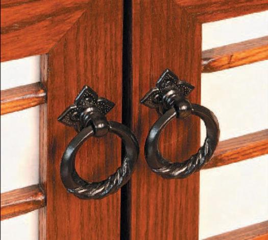

Finally, I applied a furniture paste wax to the drawer slides to allow for easy movement, and fit the tansu with hardware.
Handles

Drawer

Secret compartment door
Secret compartment detail
