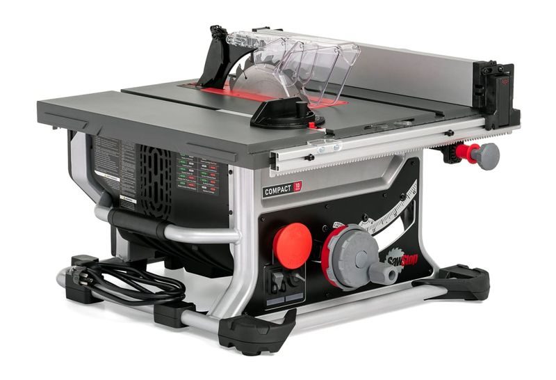

The SawStop CTS sets the standard for quality, convenience and safety on a jobsite or in a small workshop where floor space is at a premium. It works great, operates smoothly, makes accurate cuts and has the best bevel system on the market.
The saw is light enough for one person to move it around and compact enough that you can store it under a worktable. It offers durable quality, exceptional safety features and the power and precision you need to process stock up to 3-1/8″ thick.

The SawStop CTS employs a direct drive 15-amp universal motor with a no-load speed of 4,000 RPM. SawStop has chosen not to list the horsepower (HP) rating for the saw, claiming that HP levels can be confusing and misleading. There’s good reason for this. While there is a standard definition to go by (one HP is equal to 745.7 watts or the amount of power used to raise 550 pounds 1 foot in 1 second), the way output is calculated by manufacturers isn’t consistent. And, of course, the quality of the components used in the manufacturing of the motor will affect its efficiency and performance.
It’s not surprising to find SawStop using a direct drive universal motor on the CTS. Direct drive motors transfer energy very efficiently with little energy loss. They also provide large amounts of power in quick bursts with constant torque and at variable speeds. They’re smaller, lighter in weight and generally require less maintenance over the lifespan of the saw. And they cost less to manufacture than belt drive motors – which helps to keep the consumer price lower. One downside is that they’re louder and generally don’t last as long as belt drive motors.
Perhaps as a result of using a direct drive motor, the CTS doesn’t accept a dado set, which is a minor inconvenience, as you can use a router table or handheld router and jig to mill dadoes and grooves.
The CTS weighs in at 68 pounds. With the optional CTS-FS folding stand attached it tops out at 86 pounds. That might seem like a lot but it’s still less than the Bosch and DeWalt (at well over 100 pounds each with stand attached) and a full 27 pounds lighter than the SawStop JSS Pro table saw. Because the CTS is essentially a 2-foot cube it’s compact enough to be moved around by anyone with a strong back.
