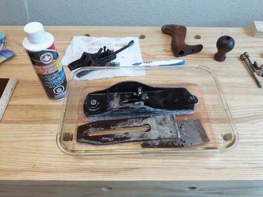

Once disassembled, I use a wire brush or wire wheel to remove as much rust as I can. I then give all the metal parts a bath. Use either a glass or plastic container and pour in enough rust solvent to cover the parts. I’ve tried various vinegar/baking soda concoctions in the past, but I find they take a long time to work. I now use Rust Dissolver Gel (Homehardware.ca) that does the job in 30 minutes. Halfway through I vigorously brush all the parts with an old tooth­brush or bristle brush. After the bath it’s time for a good rinsing in hot water.
get rid of rust
Get Rid of Rust – Using Rust Dissolver Gel, Duguay gives the parts a bath to remove as much rust as possible. Some scrubbing with a toothbrush part way through the process speeds the removal.
