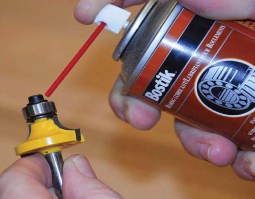

If you are working with a piloted bit, one with a bearing on top, remove this bearing with an Allen key. Bearings are one of the first things to fail on a bit. They guide the bit along the edge of a work piece and must spin freely to avoid marking the wood. As the bit is used, minute particles of dust will get trapped in the bearing and will slowly reduce its ability to rotate freely. When the bearing spins relative to the wood along which it is moved, it will start to leave a faint shiny surface behind. If the dust prevents the bit from rotating it will leave a burn mark on the surface. Remove the bearing carefully as some brands have small brass washers or shims under them that can easily get lost. Place the bearing into a small sealable plastic container (my favourite is an old 35mm film canister), add a little Varsol, and then shake it vigorously for a few minutes. Remove the bearing from the solvent and place it on a piece of paper towel to wick out the excess solvent. I also use compressed air to blow out the bearing as well. Never hold a small bearing in your fingers and then direct a spray of compressed air at them, as this is a dangerous practice, instead, wrap the jaws of a cheap set of pliers with electrical tape to protect the surface of the bearing and then use this to hold the bearing when you blow it out. If you can’t restore the bearing to new condition using these methods, replace it with a new one. Before treatment with the Bostik bearing lubricant I can hold a bit by the bearing, and when I spin the bit freehand, it will make about 4 revolutions before stopping. After treatment and cleaning, the same bearing will spin at least a dozen times before stopping.

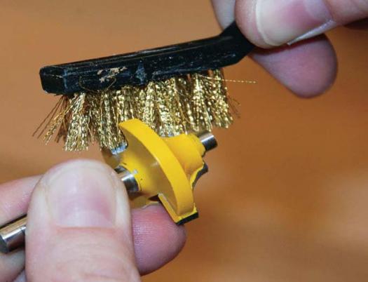

With the bearing removed you will be left with a solid bit of steel to clean. Several companies make proprietary cleaning solutions for edge tools and these can make the job easier. Products such as Blade and Bit from Boeshield (boeshieldcanada.com), and Freud’s Fresolv (freud.ca), are designed to dissolve the pitch and make it easy to remove. It has been common practice for some woodworkers to spray their bits and blades with oven cleaner and then to attack them with a brass brush. However, research by Freud has found that oven cleaners are very corrosive (you are not told to wear gloves during use to make a fashion statement!) and that it will degrade both the carbide edges as well as the brazing that holds the carbide to the body of the bit. Pay particular attention to the stud on top of the bit that the bearing mounts to and clean this area thoroughly. Be sure that there is no debris inside the threaded hole before you reinstall the bearing or you may never get it off again.

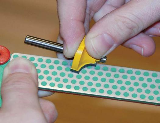

The point of contact between the router and the bit is the collet and shaft and these should receive careful attention as well. Any build-up on the shaft or on the collet will cause your bit to either slip during use or, more likely, to seize in the collet making it impossible to remove. Clean and inspect the shaft every time you change the bit. I use some cleaner and coarse steel wool to remove stubborn residue and just some medium steel wool in between major cleanings. Give your cutting edge a quick visual inspection every time you change the bit, but if you are doing a major clean up of your bits, inspect the cutting edges with a loupe. The loupe will magnify the edge allowing you to check it closely for nicks and dulling. If your bit has major chunks missing from the edge, then the damage may be too severe to repair by sharpening. For edges that are not badly chipped you can use a small folding diamond hone to dress the back (flat) edge of the profile. I prefer the Diafold hone, (leevalley.com), from DMT, (dmtsharp.com). This foldable hone has 600 grit on one side and 1200 grit on the other. A couple of stokes is all it takes. This diamond hone is meant to be used dry so there is no mess to clean up.
Reinstall the bearing and tighten the Allen screw completely. Check this screw after using the bit a short while to be sure it is still tight. Before using the bit, apply some bearing lubricant to the bearing if it has one. This lubricant will keep the bearing spinning freely without attracting and trapping dust, which will ultimately destroy it. I also spray my bits (and other cutting tools for that matter) with DriCote cutting lubricant. It does a good job of inhibiting glue, pitch, and resin build-up on cutting surfaces, and reduces cutting friction, and hence heat build-up.

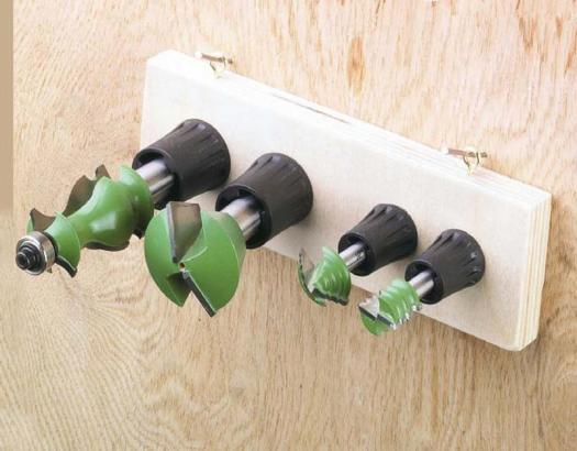

Invest in some decent storage for your bits. Keeping them loose in a drawer is sure to damage the edges. Drilling holes in a piece of wood to store them is not the best option since moisture from the wood may cause corrosion on the shafts, which will ultimately cause them to stick in the collet. I prefer to use the composite bit holders available through Lee Valley that can easily be screwed to any surface where they are needed. Whether built into a cabinet or a wall, proper bit storage will safeguard your investment in these expensive accessories.
