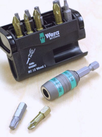

wera driver bit set
Quality Bits, Small Case – Wera offers a wide range of Torx and Pozidriv bits and a quality adaptor, all in a handy carrying case. They offer different sets that also include Robertson and Phillips bits.

wera bit set
Wera Rapidaptor – Press a bit into the Rapidaptor by Wera and it will be held in place until the user manually removes it by pulling back the outer ring of the holder to pop the bit out. It’s a good solution to both holding the bit in place during use, and allowing the user to easily remove the bit after use, even if they have gloves on.

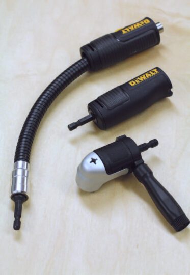

Dewalt driver extension
Right-Angle Driving – This modular 4-in-1 system from DeWalt offers compact right-angle, standard right-angle, right-angle flexshaft and straight flexshaft operation.
