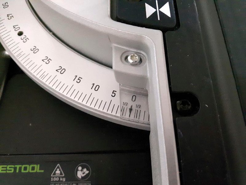

Setting a mitre angle is very quick and there are standard detents for the com­monly used angles. The mitre range is a generous 60° left and right. Setting the bevel angle is more time consuming. The bevel scale is small and harder to read, and there isn’t a fine adjustment to help you set the exact angle. I use a digital angle gauge to speed things up. The bevel range is 47° left and 46° right. If you do much in the way of renovation or carpentry work you’ll love the angle transfer device that comes with this saw. You use the device to replicate an inside or outside angle and then transfer the angle to the saw without having to make any complicated calculations. It works like a charm.

Easy on the Eyes – Reading the simple mitre scale is easy, and reduces mistakes and increases speed.
