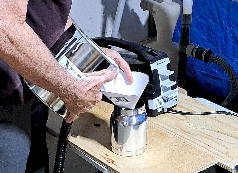

In my tests, I used the Earlex 5700 to spray water-based polyurethane, a common choice for hobbyist projects. I strained the polyurethane before spraying. If you’re going to be spraying latex paint you might want to dilute the paint with approximately 10% distilled water (about 12 ounces per gallon).

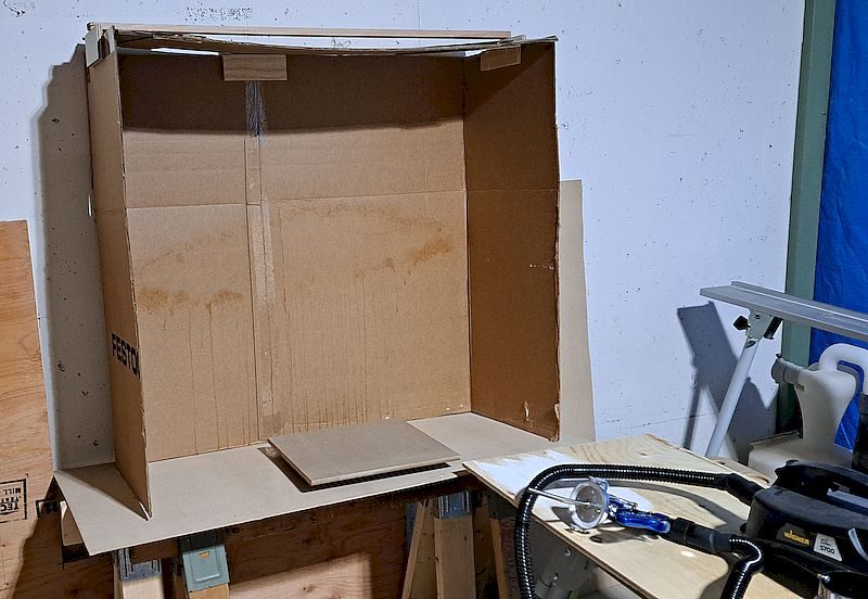

If, like me, you only spray occasionally — perhaps once or twice a month — you don’t need a dedicated, heavy-duty spray booth. A simple, quick-to-assemble booth made from cardboard works beautifully. I use one large box for the sides and back, then cut a second box into two panels — one for the top and one for the base. The result is sturdy enough to handle repeated use, surprisingly durable, and best of all, completely free. You could also use a sheet of 1/2″ rigid foam insulation.

Filtering finish
It’s a good idea to filter your finish to remove any impurities.
Spray booth
No need to get fancy – easy to assemble and dispose cardboard booth.

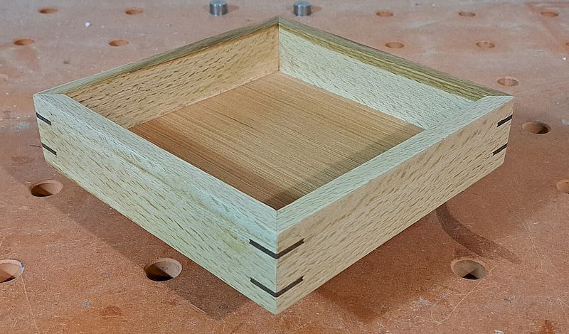

Sprayed box
No drips or sags – just a clean, even finish.
