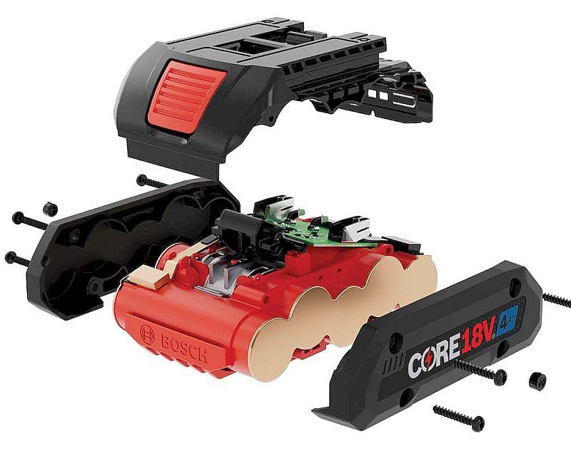

These cells are wired in series to create the required voltage — the electrical poten­tial or power output. A 12V pack has three cells, and an 18V pack has five cells.

Bosch battery pack
Voltage – As you can see here, this 18V pack has five individual cells, each with a nominal voltage of 3.6V. (Photo by Bosch)
