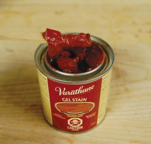

Gel stains are the consistency of peanut butter. Because they don’t run, they’re ideal for use on vertical surfaces and where you have a lot of narrow edges and crevices, as well as on carvings and turned items. They’re also the best choice to use on blotch-prone woods (see below).

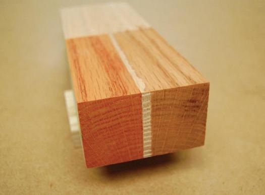

Pay special attention to end grain. The deep open pores provide cavities for the stain to lodge in, which is why end grain usually stains darker than face or edge grain. You can resolve this by sanding the end grain much smoother (which burnishes the pores and reduces their ability to absorb stain), or applying a wood conditioner, or you can do both.

Gel Stain
Gel stain is very thick. Because of this, it tends to not penetrate into the wood. It remains on the woods’ surface, where it more evenly colours the wood.

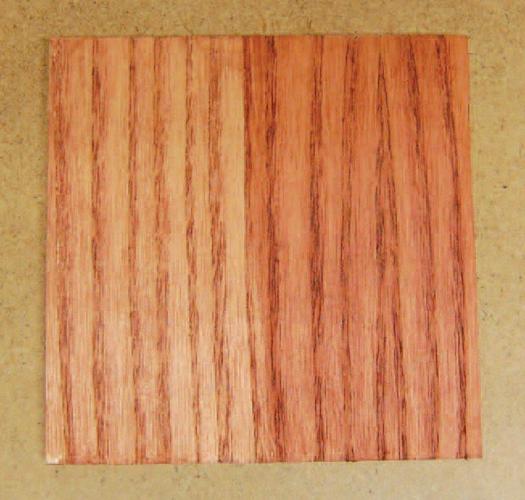

How Many Coats?
 Here, Duguay stained an oak sample once, then taped the left half of the sample off, and stained it again. The wood is darker with two coats of stain. There are diminishing effects as you apply more and more coats.

More Sanding, Less Absorption
Duguay sanded the face grain of this sample to 150 grit, and the end grain to 600 grit. The higher sanding grit lessened the end grains ability to absorb the stain, and therefore creates a more even look.
