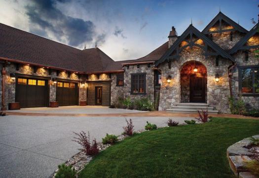

Stone and Brick
Brick and stone siding has a distinguished look, comes in a wide variety of textures and colours, and, with proper care, lasts for generations. However, because the materials are so heavy, they require support at the foundation, which can significantly increase the cost of installation on an existing home. As a result, most homeowners choose a veneer form, which is much lighter in weight and less expensive. Stone and brick veneer siding comes in natural and synthetic materials. While traditional stone and brick require professional installation, veneer is DIYer installable.
Cost: $$$$$ (traditional); $$$ (veneer)
Pros: Durable, resists weathering. Virtually unassailable from pests, insects, mold, and fire. Very low maintenance.
Cons: Traditional products are expensive to purchase and labour intensive to install. Mortar joints on veneer can deteriorate over time.
Sources: CanadianStone.ca, CulturedStone.ca, PolyRoche.com
stone and brick siding
