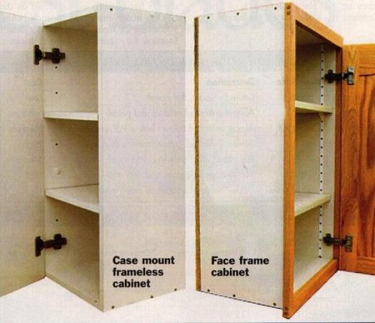

• Are your kitchen cabinets face frames or case mount style?

Face Frame Cabinets
In this style of kitchen, frames are attached to the face (the front) of the cabinets. The doors are then attached to the face frames or between the frames.
A common width for face frames is 1½”.
Overlay is the width that the door overhangs the frames. A standard overlay width is ⅝” on each side of the opening. Too large an overlay would result in the doors hitting each other as they are being opened and closed.

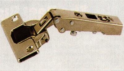

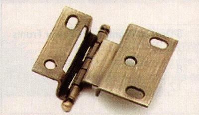

European hinges are very popular and are made for many different styles of doors. Make sure you buy overlay hinges that match the overlay width you will be using on your doors. For example, for a ⅝” overlay you will need to purchase a matching ⅝” overlay hinge. The staff at your local hardware store, building supply centre, or speciality supplier should be able to help you select the correct hinges.

Inset Face Frame Cabinets
Another type of door and drawer front for face frame kitchens is the in-set style. This is when the front is recessed into the opening between the frames. To get the size you need measure the opening and subtract 1/8″. In the example of an 18″ x 30″ cabinet, the door size would be 17⅞” x 29⅞”. For these types of doors you will need inset hinges.
Case Mount (Frameless Cabinet)
In case mount cabinets there is no face frame (which is why this style is also called a frameless cabinet). In this cabinet, the door is mounted directly onto the cabinet. To replace these doors you will have to know the width and height of the cabinet.
Begin by measuring the width and height of the cabinet from the outside. If the cabinet receives one door or drawer front, subtract ⅛” from the width and height of the door or drawer front. For a cabinet 18″ wide and 30″ high, the door size would be 17⅞” x 29⅞”. For cabinets that receive two doors you have to divide the opening in half, and then subtract ⅛” for the size that is required. A cabinet 30″ wide and 30″ high would receive two doors. The door sizes would be 14⅞” x 29⅞” (for standard sizes of drawer fronts, see: Sidebar).

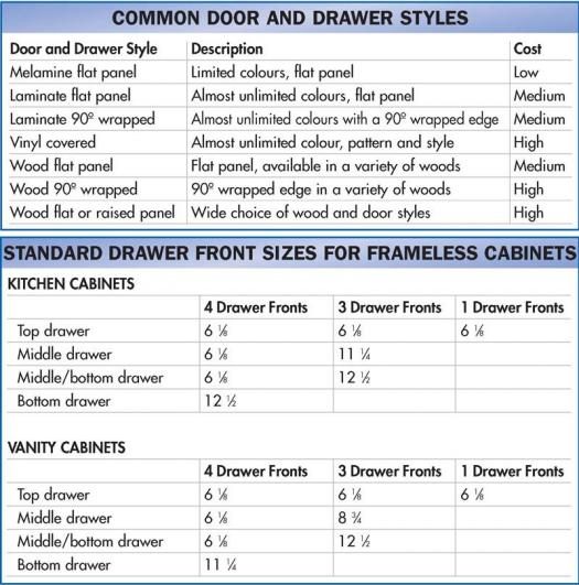

Most of us don’t have the machinery or time to make all our own doors, so a good alternative is to buy them from a local kitchen shop. The style of door is important to the look of your kitchen. There are many different styles, and pricing varies widely. Melamine flat panel is the least expensive, while solid wood is the most expensive. Before purchasing your doors take careful measurements. This is very important, as most manufacturers will not refund for measurement errors.

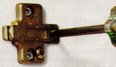

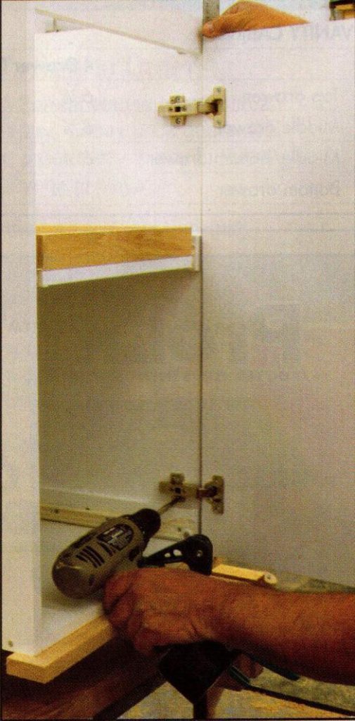

European hinges are a bit trickier to install, as you have to drill a hole in the back of the door to allow for the hinge. The width of the hole is normally 35mm, but double check manufacturer’s specifications.

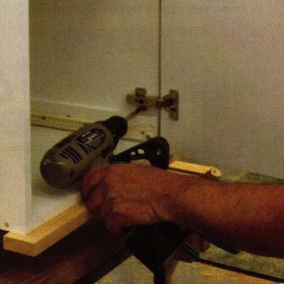

Once the European hinges are on the door, hold the door in place (in its opened position) with a ¼” spacer between the door and the front of the cabinet. Then put a screw through each hinge plate into the cabinet side. Remove the door, then finish screwing the plates on, one at a time. Continue this same process for the rest.

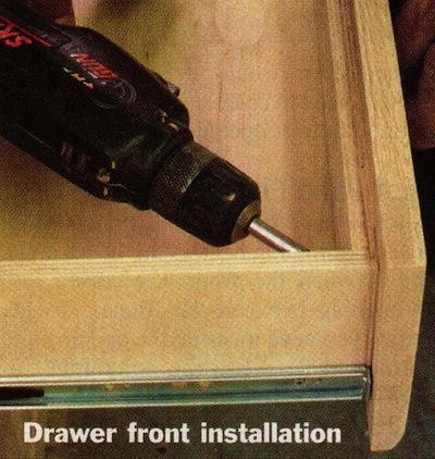

Installing fronts on wood drawers is different than on metal drawers. For wood drawers you may have to screw the front on through the drawer box itself. For metal drawers there are usually holes in the spot where you need to attach the front. The drawer front usually isn’t centered on the box, so make sure of the location before you attach the front. There isn’t a standard location for where the front is located; only that it is usually centered left to right. For a vertical location you would normally want a ⅛” gap between each front and above a door. If it is a bank of drawers you will want the bottom of the drawers to line up with the bottom of the doors. Make sure that the sizes of the screws that are used are not going the go through the front of the drawer.

No mortise overlay hinge

Hinge installation
