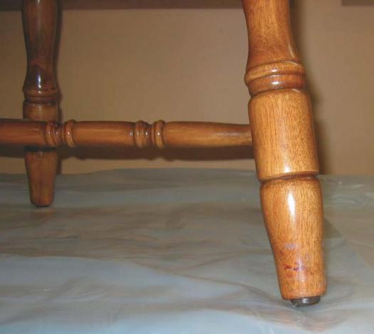

Scuffed chair leg
Common damage to the leg of a chair.

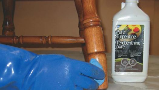

Clean the area
 First, use turpentine to clean the area around the scuff mark.

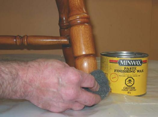

Apply some wax
Once the scuff has been dealt with apply wax with #0000 steel wool. This will smooth the area.

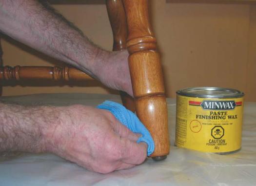

Buff to a nice sheen
With a clean rag, buff the area to an appropriate gloss.

Often old rocking chair arms will feel sticky; this indicates excessive wax build-up. The same goes for many antiques, where the linseed oil rises to the surface. The first aid for these patients is simple: dip a clean cloth in turpentine, wring it out until almost dry, and then rub the built-up waxy area until it comes clean. Repeat with a clean cloth as necessary, and if some build-up remains after two tries, lay a cloth – this time with more turpentine – directly on the problem area and leave it there for about 20 minutes to soften the build-up. If this doesn’t do the trick you’ll have to resort to using a pad of #0000 steel wool in lieu of the cloth. Once you’re satisfied the wax has been removed, wipe the area dry and give the entire piece a protective coat of wax.

If you look at the legs on any piece of furniture, odds are you’ll see scuff marks. Vacuum cleaners and kids toys are the usual culprits. First aid for this patient is quite easy. Once you’ve washed the damaged area using a clean turpentine-dampened rag, dip a pad of #0000 steel wool in paste wax that matches the general colour tone of the piece – either tinted dark or clear. Rub the scuffed area gently, ensuring you move the steel wool with the grain until the scuff marks disappear. Allow the wax to harden for about 10 minutes then buff off the excess. Once it’s hardened for another 15 minutes or so, buff again.
