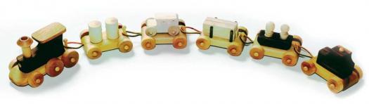

Every child loves a toy train. This simple train set is as much fun for a youngster to play with as it is for the young at heart to build.
You can build this train set with a small handful of spare wood, while the wheels, pegs, people and smoke stack are commercial toy parts (stockade.ca). The train has six interchangeable pieces held together with leather loops. Leather is safer than metal hooks, holds better than magnets, and is easier for small hands to handle.

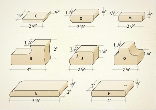

I began by shaping the bases for the engine (A) and the other five cars (H) out of 5/8″ birch, although you can also use 3/4″ stock. The engine base is a bit longer than the other bases, but all are the same width. Don’t fret if your stock is a tad narrower or wider than my dimensions. Once the bases are complete, drill holes for the wheel axles (G). The wheels I used have 1/4″ holes so I used 7/32″ x 1″ pegs. Drill holes at least 1/2″ deep. Don’t drive the pegs in too tight – the wheels need to turn freely.

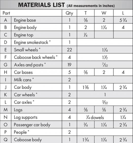

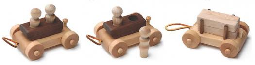

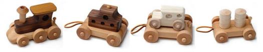

I used black walnut for the engine body (B), passenger car body (O) and caboose body (Q). Once these are shaped, drill a 5/8″ hole in the top of the engine body for the smoke stack (D), and two 3/4″ holes in the passenger car for the people (P). I also drilled 3/4″ holes 3/8″ deep on either side of the caboose for windows and installed a 7/32″ peg in the top. Don’t drill the window holes all the way through, as there is the possibility a child could get their finger stuck in the hole. Attach a top (C) to the engine (I used a small piece of pau amarillo). I purchased milk cans (I), but you could just as well use 3/4″ dowels. Use pieces of birch for the logs (M) or thick twigs -just remove any bark and make sure they are clean. The posts are simply 1/4″ dowels. They need to be about 1-1/8″ above the car base to support the logs.
The back wheels (F) on the engine are 1-1/2″ in diameter, and the wheels (K) for the passenger car (J) are 1″ in diameter. All the other wheels (E) are 1-1/4″. All the wheels use the same size axle (G) except the car (J), which uses a smaller axle (L).
Leather shoelaces make excellent pull cords. You’ll need about 4-1/2″ for each car. Drill 7/32″ holes in the front end of each car (except the engine), glue in the two loose ends of the cords, and then drive in a short piece of 1/8″ dowel to secure the cords in place. Install posts (G) on the back of each car, except the caboose, so that the cars can be connected together.
