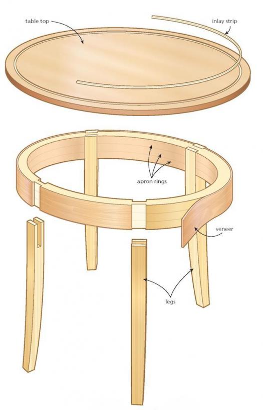

I chose a size of 29″ by 21″ for the top of this table, but you could scale it up if you want to make a coffee table. I wanted the top to overhang the oval apron by 1-3/4″, which meant the outside dimensions of the apron should be 25-1/2″ by 17-1/2″. To make the apron sufficiently strong, I made it 1-1/4″ thick and 2-5/8″ high. The 17″ long curved and tapered legs are 1-1/2″ square at the top and approximately 1″ square at the bottom. I found this leg size to work well for both this end table and larger coffee table.

Rout three MDF templates
The 1/2″ thick MDF templates for the top and apron can be cut using any of a number of ways, but my preferred method is with a shop-built elliptical router jig.
Make a 1/4″ MDF template of the curved face of the leg. Note the upper 2-3/4″ of the leg should remain straight and square since that portion will be joined to the apron. It’s worth spending a little extra time sanding the edges of the templates since any irregularities will be transferred to the finished pieces.
Build the three-layer apron
The apron is built from three layers of 7/8″ poplar, arranged in a brick-layed fashion for maximum strength. Start with the middle layer by cutting the 10 pieces to length and at the correct angles using the drawing of the middle apron layer. Glue the pieces together into a left and a right half using splines or dominos to strengthen the end-grain joints. Make sure the two halves are flat during glue-up. To ensure a tight fit of the left and right sides of the ring, I taped 120-grit sandpaper to the infeed table of my jointer and while the assembly was held perpendicular with my jointer’s fence, sanded the ends until they were flat.
Before gluing these ends together, use the apron template to mark the inside and outside edges on the wood and then bandsaw away most of the waste. You can then use splines or dominos to glue together this middle apron layer. When dry, temporarily fasten the apron template to this layer using small screws so you can rout flush to the template. This middle layer now becomes the template for the top and bottom layers.
Building up the apron with the top and bottom layers is easier. The pieces can be glued directly to the middle layer without requiring splines or dominos to strengthen the end grain joints. Ensure the joints of each layer don’t align with a joint in the middle layer. Cut all but one piece per layer using the lengths and angles shown on the drawing of the top and bottom layers of the apron. The final piece will be cut to fit precisely after the other nine pieces are glued in place. To minimize the amount of wood that needs to be routed away, bandsaw each piece close to the finished size before gluing it to the middle ring. Pin nails can be used to hold the pieces while the glue dries, provided you stay away from the location of the legs. Rout away the waste using a flush trim bit with the bearing riding on the middle ring.
Apply apron veneer
Using commercial veneer for the show face of the apron will work, but I prefer to resaw my own slightly thicker veneer. Use four lengths of veneer, leaving about a 1/2″ gap where the legs will be connected. Cut the veneer about 1/4″ taller than the apron to allow some play when gluing the veneer. I used three pieces of 1/8″ Masonite as clamping cauls and I applied packing tape to the inner caul so it would not stick to any glue squeeze out. Be sure to do a dry run before applying glue to the veneer. You will need quite a few closely spaced clamps on the top and bottom of the apron to ensure the veneer is pulled in tightly to the apron.

Glue the top from a single board
I sorted through my stock of cherry to find a single board that I could use for the top. This helped to get a consistent grain pattern and colour. After machining to a thickness of about 7/8″, glue the top together and sand or handplane the surface flat.
Using double stick tape, fasten the MDF template to the workpiece and head to the bandsaw to cut close to the template. I used a combination of a flush trim bit and a template bit to rout the top to the final size, making sure I was always routing downhill.
To give the top a little more character, I inlayed a 1/16″ wide strip of maple about 1″ from the edge. Cutting the groove for the inlay can be done by hand, but I chose to use my trim router with a shop-made base that has two bearings that ride against the outside edge of the top. Go slowly with this step so that you keep both bearings in contact with the edge. I cut the maple inlay on my bandsaw and then handplaned a slight taper to get a tight fit when glued into the top. As a final step, relieve the underside of the top with a thumbnail router bit taking a number of passes before getting to full depth.
