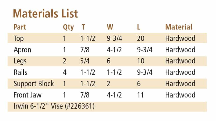

I made the top out of 1-1/2″ thick maple. Another option is to use two layers of ply glued together.

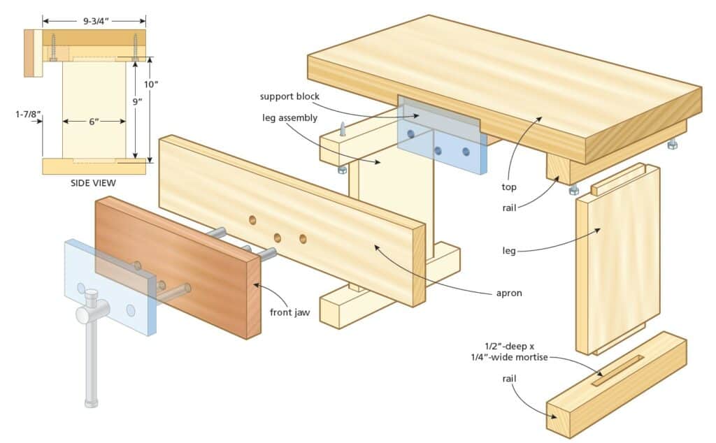

I installed an Irwin 6″ vise in my bench. You probably want to avoid installing a heavy vise as it will likely put too much weight on the front of the bench, causing it to tip in use. A BOB isn’t really for heavy work, so a large vise isn’t needed. A groove on the underside of the benchtop was needed to allow the vise to sit at the proper height. A support block screwed to the underside of the top provides extra rigidity for the fixed jaw screwed to the back face of the apron. After temporarily installing the fixed jaw, I marked the locations of the guide bars and threaded rod, removed the jaw, and then drilled clearance holes in the apron. I reinstalled the fixed jaw and then glued the apron to the top.
Before making the legs, I propped the top onto my workbench, trying out different working heights. A low-profile scissors jack works well for this (or small cardboard boxes and cut-offs of plywood). For me the sweet spot turned out to be 11-1/2″, neces­sitating 10″ tall legs.
Each leg consists of two rails with a 3/4″ vertical slat assembled in an “I” style. There are a lot of options when fastening the slats to the rails. I cut a 1/2″ deep mortise into the upper and lower rails, then sized the tenons on both ends of the slat to fit. Other options could include lag bolts or long screws holding the parts together, or a series of dowels or Dominos. Use whatever approach you’re most comfortable with.
The leg assembly is bolted to the top with 2″ lag bolts counter­sunk into the upper rails. Fairly wide feet add stability. I applied self-adhesive, high-friction tape (Lee Valley #99K3401) to the bot­tom of the feet. The tape works extremely well on reasonably smooth surfaces. Occasionally, when doing a bit of aggressive chis­elling or planing, BOB gets a bit feisty, so I clamp his feet to the workbench.
Mark and drill holes in the front jaw for the guide bars and threaded rod, then screw the vise’s movable jaw to the front jaw. If you intend to put dog holes in the top, ensure the front jaw is at least 1-1/8″ thick to accommodate a 3/4″ dog hole. I neglected to do this and had to beef up the front jaw when I finally installed dog holes.

Extra Blocking
Duguay had to make a notch in the underside of the top to allow the vise to be positioned properly, though each vise is a bit different. Here the vise is shown with the support block in place, ready to be screwed to the underside of the top and the rear face of the apron.
