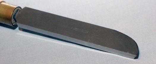

The surface of the cylinder will be smoother when a skew is used to make the cuts rather a spindle gouge. However, there are specific cutting techniques that must be learned in order to use a skew successfully. A skew has two bevels and is available in various configurations. I prefer a ¾” (19 mm) wide by ¼” (6 mm) thick skew with a slightly curved cutting edge. I feel this type of skew is less aggressive and cuts shallow coves on spindles a little easier. Skews are available with a straight cutting edge if preferred. I feel that it is a good idea to either buy a skew with the side edges round or grind the sharp corners off to reduce the tool’s tendency to bind on the surface of the tool rest. Some skews have an oval cross-section that can be useful for cutting curves but can cause difficulty when trying to get an even surface on the cylinder. The cutting edge is usually ground at a 45° angle to the side of the tool.

(b)  Round-nose scraper – ¾” (19 mm) wide by ¼” (6 mm) thick
(c)  Square-end scraper – ¾” (19 mm) wide by ¼” (6 mm) thick
(d)  Side-radius scraper – 1″ (25 mm) wide by ⅜” (10 mm) thick

One of the most useful tools in the bowl/faceplate turning tool kit is a side-radius scraper. It can be very helpful for creating a smooth flowing curve on the inside surface of the bowl from the center of the bottom to the inside edge of the rim. This tool has to be very robust; I suggest it be at least 1″ (25 mm) wide by ⅜” (10 mm) thick. This scraper has a rounded tip that extends back along one side to allow a longer cutting surface that yields a more even and continuous scraping cut from the center to the rim on the inside of the bowl.
Side Radius Scraper
Side Radius Scraper
