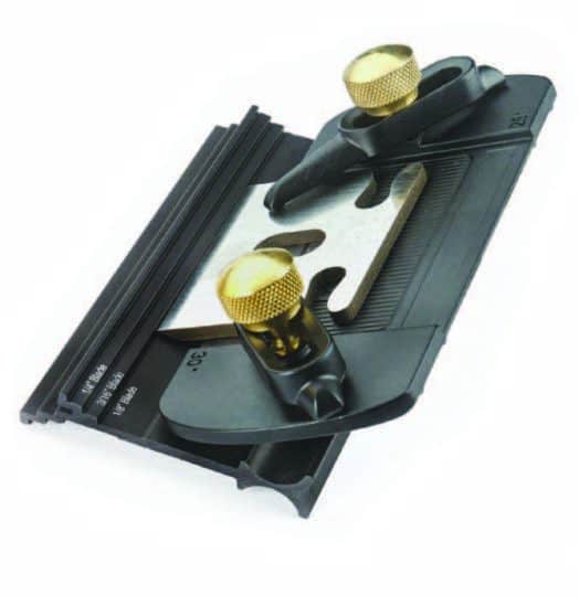

If you have several short blades, then the Veritas Short-Blade Honing Guide (#05M0930) is a worthwhile addition to your hon­ing arsenal. Made of the same durable material as the side-clamping guide, it’s designed to hone blades and chisels at either 25° or 30°. The guide comes with a registration jig and a shim that enable you to hone blades that are 1/8″, 3/16″ or 1/4″ thick and up to 2-1/2″ wide. Two metal holding fingers secure the blade firmly in the guide. Because the end of the blade rests flush on the registration jig it’s guaranteed to be at the proper angle. The included shim enables you to create a micro bevel on blades. I found the guide easy to set up and handle. It’s particularly useful for honing skewed blades, which can’t be done on the side-clamping guide, and requires the purchase of an accessory jig for use with the Mk.II. It’ll also make quick work honing the narrow side rabbet and combination plane blades.

For Unique Blades – When sharpening short blades or sharpening at an angle, the Veritas Short-Blade Honing Guide gets right to the point.
