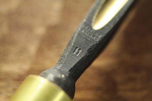

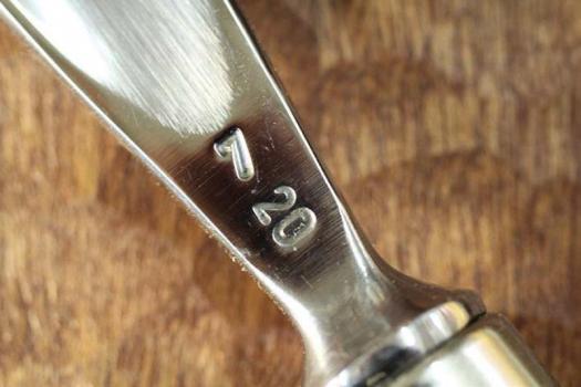

Clearly Marked? Swiss Made, Two Cherries, and Stubai tools have their sizes clearly stamped on them (upper). While Henry Taylor tools were stamped, it was difficult to read the number (lower). Flexcut tools were not numbered.
