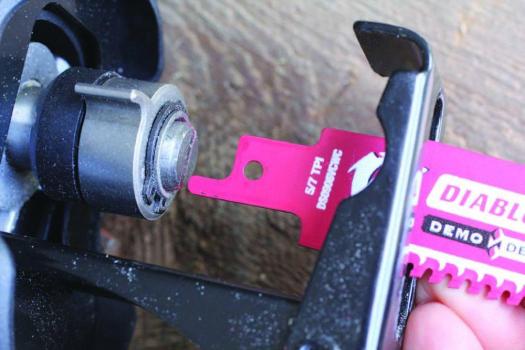

The shank
The shank locks into a recip saw’s blade clamp. Fortunately, all recip blades have the same size shank, which means any recip blade will fit into any recip saw. Recip saws won’t accept jigsaw blades.
Universal Shank – The universal shank will fit any brand of recip saw. The blade can also be used while rotated 180° in the chuck. This will allow the user to cut upwards or downwards, depending on the situation.

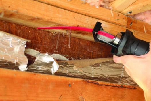

General purpose or demolition blades often have a variable tooth configuration that makes the blade suitable for cutting nail-embed­ded wood and metal, depending on how you position the blade. Coarser teeth for cutting wood and nail-embedded wood are at the front of the blade, while finer teeth for metal are close to the shank.

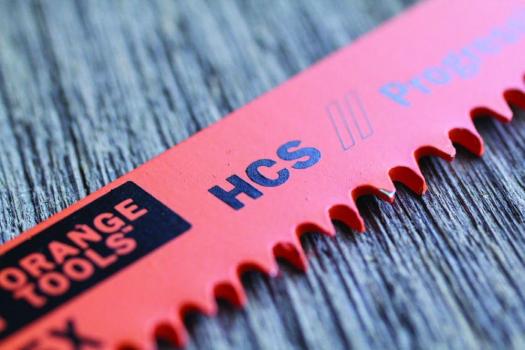

These are the least expensive blades you can buy; both blade and teeth are made of HCS. Because the blades are fairly flexible, they’re not overly prone to breaking, though the teeth deterio­rate quickly. These blades are best used for cutting clean softwood, hardboard and plastics, and not recommended for demolition work or cutting metal. The blades can have variable-sized teeth and gul­lets for faster chip removal.

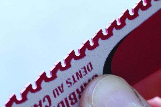

These are the toughest, longest-lasting blades you can get. The blade is typically bi-metal, with heat-resistant and impact-resistant tungsten carbide or titanium carbide teeth. They’re a better choice when you have a lot of nail-embedded wood or metal to cut (including stainless steel and high strength alloys). They cost more than standard bi-metal blades but last considerably longer, giving you a much better return on investment.

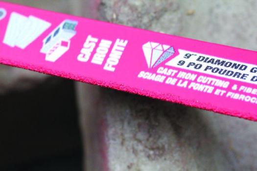

Use these blades for masonry, ceramic tile, fibre cement, cast iron and the like. Just remember: they don’t cut, they grind. Wear a res­pirator to avoid breathing in the fine particulate material. Diamond blades cut faster and last longer than carbide blades, but cost more.
