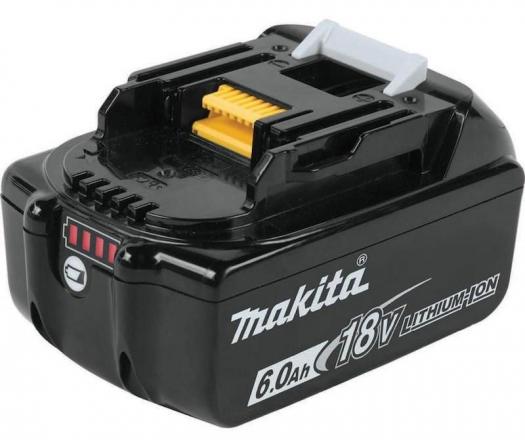

makita battery

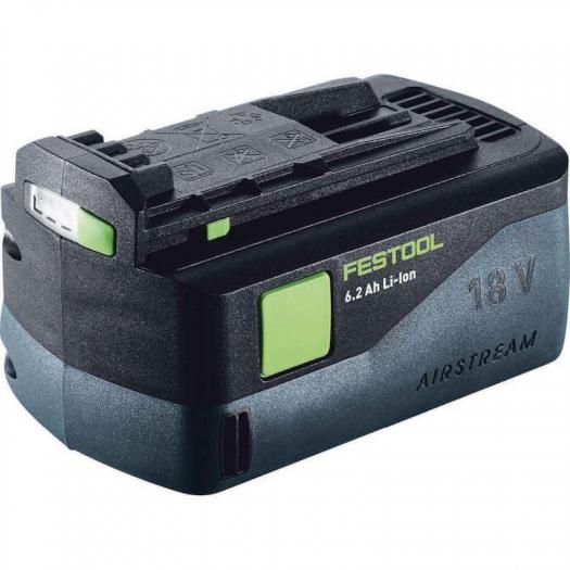

festool battery
Getting Bigger – About a year ago Makita and Festool  both introduced 6.0 Ah or greater batteries for their cordless tools.

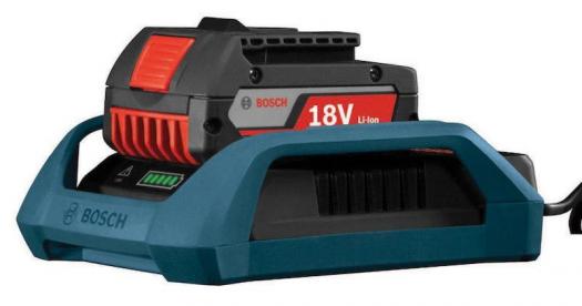

Bosch seems to be the only company involved in wireless charging. With the WC18CF-102 charger you don’t need to remove the battery from the power tool, you simply place the tool on the charger when the tool is not in use, which has the effect of incrementally charging the battery, and saves you the hassle of regularly removing/reinstalling the battery. However, it doesn’t work with existing Bosch 18V batteries, only with wireless-ready batteries, and currently there are only 2.0 Ah slim pack and 4.0 Ah fat pack batteries. The technology is similar to what’s used for wireless phone chargers. Current is transmitted via an alternating magnetic field from a coil in the charger to a coil in the battery. A full battery recharge takes about the same time as a standard charger. The greatest beneficiaries for this technology will be production shops and assembly lines where power tools are used on a constant basis throughout the workday.
bosch wireless battery
Wireless Charging – Bosch’s new charger allows their 2.0 Ah and 4.0 Ah batteries to be charged without removing them from the tool. Just place the tool on top of the charger, and charging will immediately begin.

festool battery
Cooler Times – Festool’s new chargers cool their batteries by circulating air through intakes on their batteries, reducing charge time dramatically.
