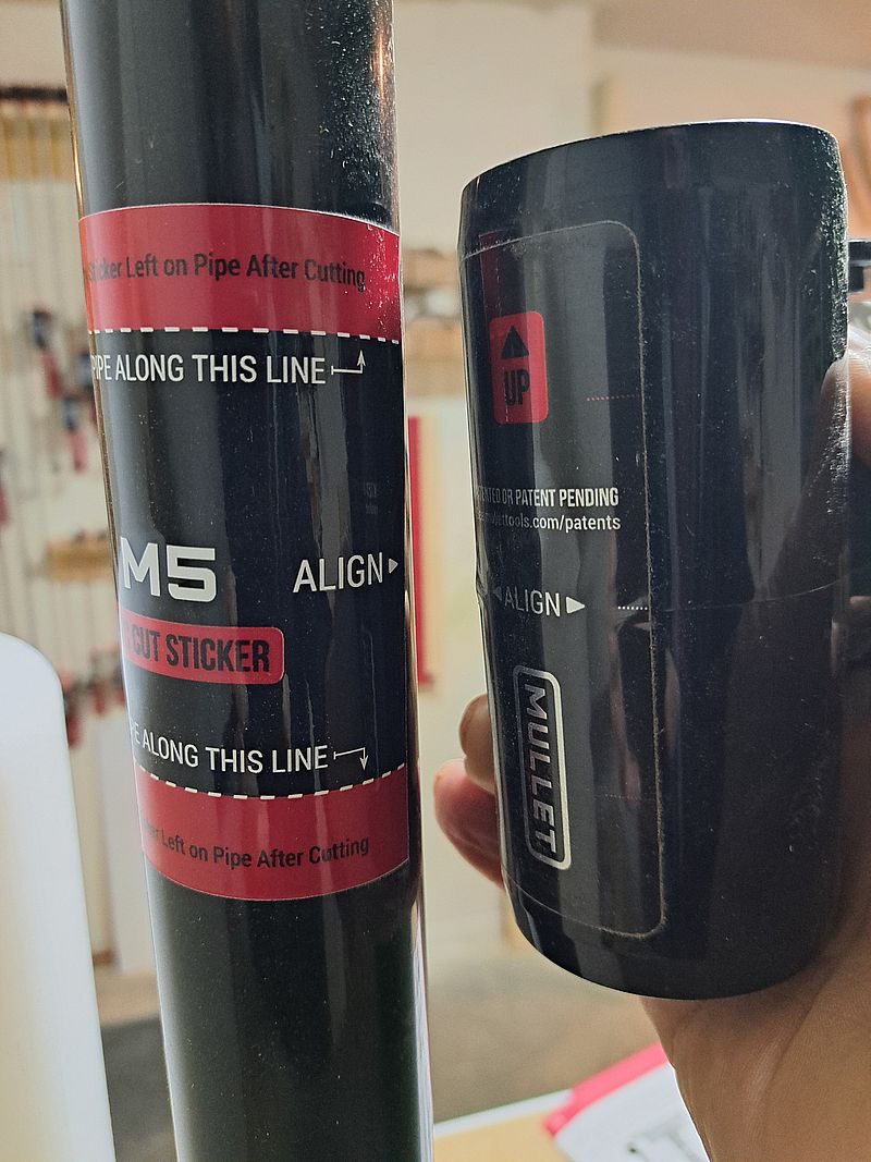

A cut sticker makes it easy to determine where you need to cut the 2′ PVC pipe – and you don’t have to worry about making a surgically-precise cut. You can be a tad off and the connection will work out perfectly.
