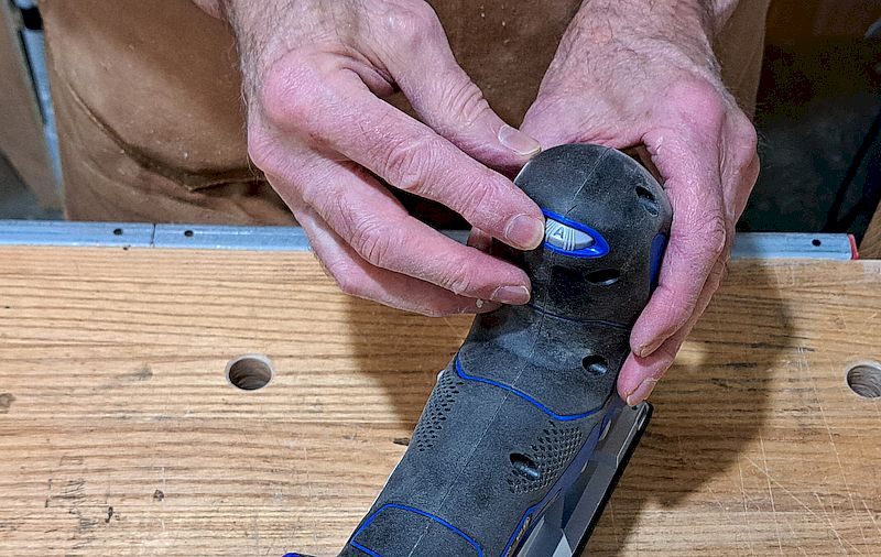

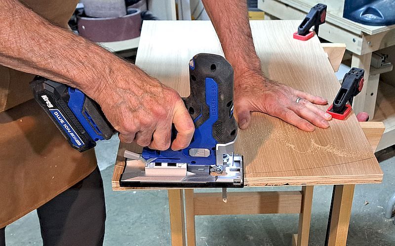

In use, the jigsaw maintains steady speed even under load — something I noticed right away when cutting through 3/4″ ash. The variable speed dial, which has 6 settings from 6,000 to 10,000 RPM, lets you fine-tune the rate for different materials — slower for metal or plastics, faster for wood. There is also an auto (A) setting — where I usually keep the speed setting dial parked. In auto mode the jigsaw starts slowly at the beginning of a cut, then accelerates through the rest of the cut. I think it helps to deliver a cleaner cut line (assuming  you’re using a good quality blade).
The four-position orbital control — when the blade also moves slightly forward on the upstroke and back on the downstroke — gives flexibility between clean and aggressive cuts. The higher the orbital setting, the more aggressive this motion becomes. I use the orbital control turned off (set to 0) when cutting hardwood. It gives me the smoothest and most precise cuts and helps minimize tear-out. When cutting MDF or plywood I move up to the 1 setting as I get a good balance between cutting speed and control. I only use the higher settings for making quick, rough cuts that I’ll later fair with a hand plane, spokeshave or sander.

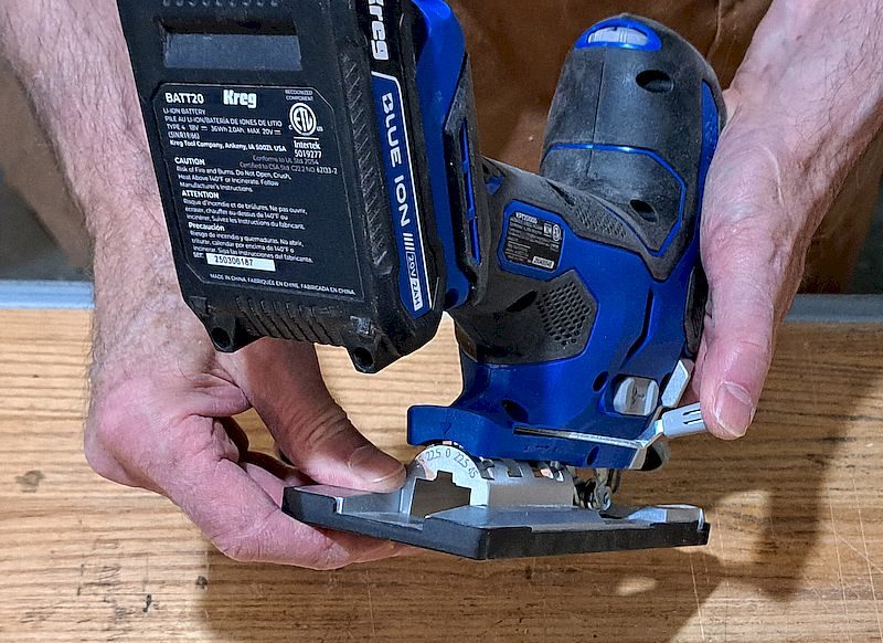

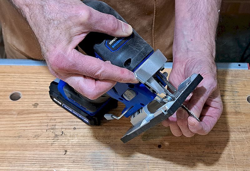

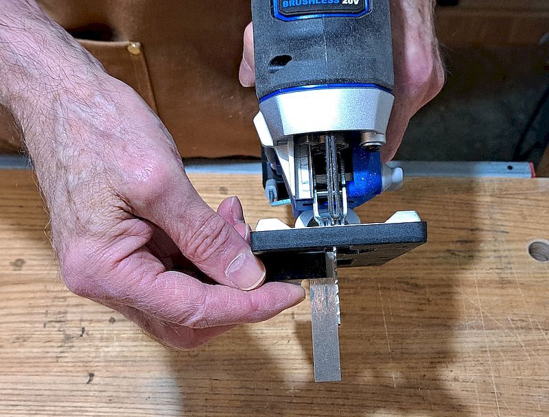

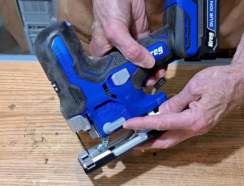

Blade changes are super quick and tool-free, and the adjustable base makes bevel cuts up to 45° straightforward. There are visible detents at 0°, 22.5°, and 45°. At 0° the base is perfectly square to the blade.

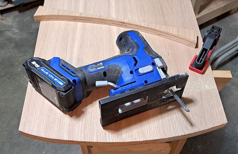

What stands out most about Kreg’s new jigsaw for me is how refined it feels in use. The motor runs smoothly with minimal vibration and the trigger response is excellent. For hobbyists and DIYers who already rely on Kreg’s cordless platform, this jigsaw is a logical and capable addition — and even if you’re just looking for a reliable, well-thought-out cordless jigsaw, it’s one that’s worth a closer look.

Speed control dial with automatic setting for gentle start before ramping up.
Kreg KPTJS100A jigsaw

Easy bevel control with 3 pre-set angles.
Tool-free blade insertion and removal.
Blade is perfectly square to base.
Smooth cutting with a well-balanced tool.
