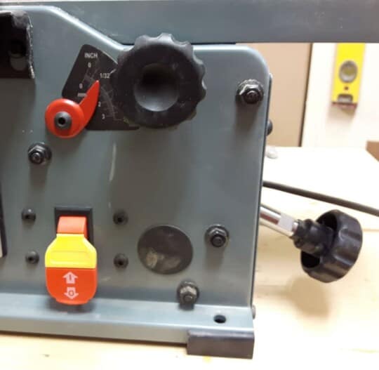

KC-6HJC
The large infeed table lock knob and depth of cut adjustment knob are easy to adjust. Depth of cut adjustments in 1/64″ increments are quick and easy to make. Finer adjustments take a more delicate touch. The on/off switch is smack dab where it should be.
