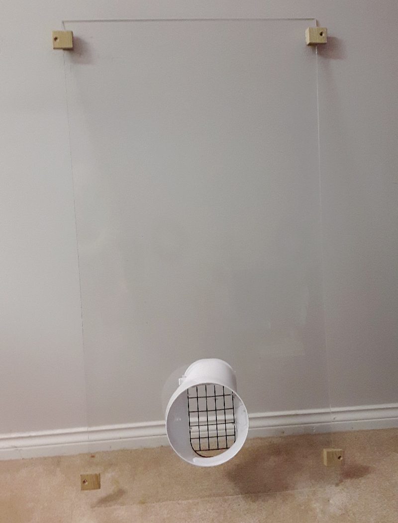

If you have an awning or casement window you can’t use the included window kit. You’ll need to make a screen that covers the window opening and to which you can connect the exhaust hose. The easiest thing to do is have a sheet of 1/8″ to 1/4″ acrylic (aka Plexiglass) cut to the inside dimension of the window. I had mine cut at Industrial Plastics (just search ‘acrylic sheets’ on the internet). At the same time have them cut the opening to attach the exhaust connector. You’ll then need to attach mounting blocks to each corner of the sheet. I made mine out of hardwood and then epoxied them to the acrylic sheet (you could also screw the blocks to the sheet). A hole in each block enables me to screw the sheet to the window frame.
acrylic sheet
Acrylic sheet cut to window size with exhaust connector attached.

  2. You screwed into your window frame? Hmmm… In my case I found that a snug fit into the frame with a bit of weatherstripping held the plastic in without needing to make holes.
    The efficiency of those single-hose portable A/Cs is awful… I don’t know why the two-hose portable ones are so hard to find.
    • I used 1/4″ acrylic and found that whenever I disconnected the exhaust hose the sheet came loose (I move the AC from room to room). If the weatherstripping holds yours in place so much the better Jim. While dual-hose units cool an area quicker and more efficiently, single-hose units consume less energy and typically cost less to purchase – so I wouldn’t consider them to be awful. It’s a matter of weighing out what’s most important to you. Whynter, Midea, Haier and Honeywell all make dual hose portable ACs.
