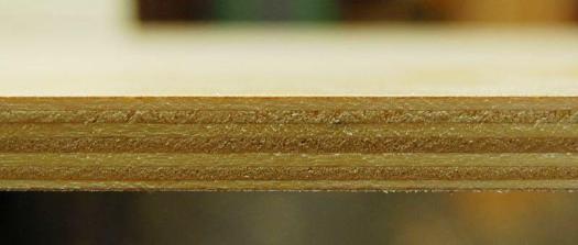

The Festool TS55EQ and TS55REQ track saws have become industry standards for processing full sheets of plywood. Because you can make such accurate cuts and there is no chip-out you don’t have to finish cut the ply on the table saw. You can still use the table saw for processing smaller sheets.

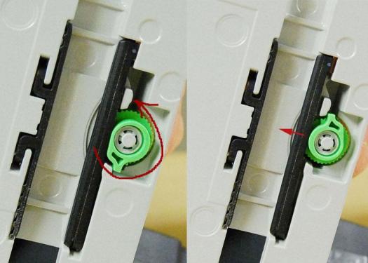

If there is any wobble, or side-play as the saw moves along the guide rail, the cut line won’t be perfectly straight. To ensure that the saw and rail work seamlessly there are two cam adjustment wheels on the top side of the saw. As you turn these wheels, cams apply pressure against rubber pads that serve to minimize side-play. The aim here is to have the saw glide freely along the rails without binding or without your having to exert any undue force on the saw – a tiny bit of side-ply is acceptable.

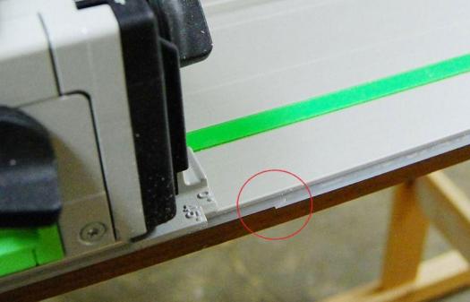

The rail bottoms have two black slip-resistant rubber strips that help to keep the guide rail from moving about on your stock. I find them amazingly effective. These strips also prevent the bottom of the guide rail from marring the surface of the work piece. Festool sells special clamps that enable you to lock the guide rail onto your work piece, but I find that I rarely have to use them.
On the bottom edge of the rail there is also a clear, replaceable zero-clearance splinter guard strip. This splinter guard strip runs the length of the rail, and extends a few millimeters past the side of the rail. The first time you use the track saw it cuts the strip flush with the side of the saw blade. As with a zero-clearance insert on a table saw, the splinter guard goes a long way to eliminating chipping and tear-out.

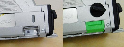

On the blade side of the track saw is a clear, plastic viewing window, though which you can monitor the cut line. The only time I’ve used this feature is when sawing without the use of the guide rail. At all other times, I replace the viewing window with the green splinter guard. A single splinter guard comes with the TSC55 – you can purchase a 5-pack for around $26. As with the splinter guard on the bottom of the guide rail, the saw blade will cut through it to create a second zero-clearance guard. This effectively provides zero clearance support on both sides of the blade.

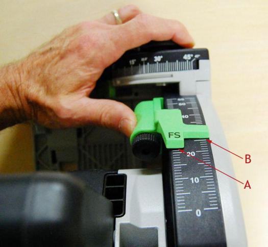

The second feature that distinguishes this saw is how easy and precisely you can adjust the cutting depth of the blade. Blade depth is controlled by depressing a depth stop slide. The slide has two index positions. The index labeled “A” in the photo below is used to indicate the blade depth when when you’re using the saw with a guide rail, while the “B” index indicates the blade depth when you’re using the saw without a guide rail. The default scale is metric, but Festool thoughtfully includes an imperial sticker that you can apply over the metric scale. Each increment represents 1mm or .039″. Note that if you use the imperial scale each registration line on the scale represents .078″ and there will be a .039″ increment in between each registration line on the scale.
I’ve been using a Festool track saw for several years, and so have become accustomed to the depth stop slider. Still, I do find that when I try to make blade cutting depth adjustments too quickly, the slider can be somewhat awkward to position – usually it takes a couple of tries to position it exactly where I want it to go. This might be due to the fact that the notches that engage the slider are very close together (.039″). However, a small price to pay for such accuracy.
Should you require even more precision in setting the depth of cut, you can use the fine adjustment depth control knob atop the depth stop slider. I’ve never had occasion to use this feature, but it’s nice to know it’s there should the need arise.

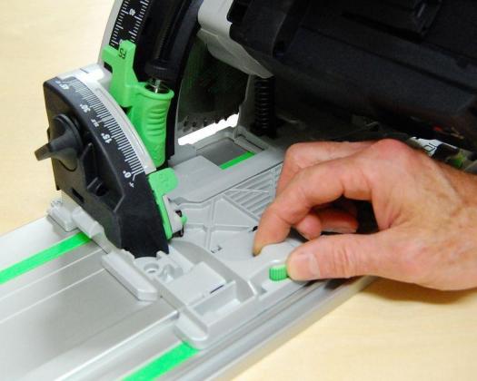

This is a feature that finish carpenters might find useful. There is a simple detent-override feature that enables you to extend the bevel cut capacity past 90° and 45°. Both features are easy to use. For some reason Festool chose not to include any detents between 0° and 45°, which would have been convenient.
