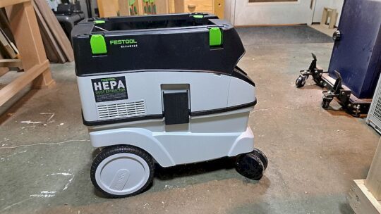

Appearance & Size

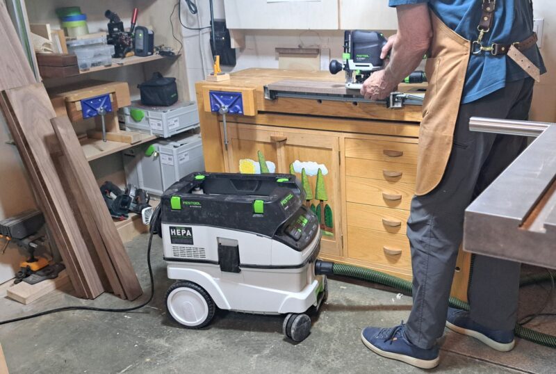

The CT 26 E I features a low-profile, rectangular design (approx. 25″ x 14″ x 22″) that’s far more stable than the typical round-top shop vac. Its low center of gravity, smooth-rolling wheels, and front swivel casters make it nearly impossible to tip over — even when tugging on the hose.
Short and squat provides lots of stability

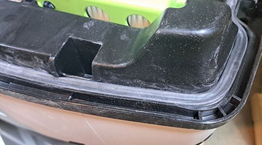

The unit is split into two parts: a top motor and HEPA filter and a bottom dust bag and storage bin. Two durable metal latches keep them locked tight, and the gasketed seal between them keeps dust and moisture out. Inside, the motor is fully enclosed to protect electronics from dust. Ventilation openings under the control panel help circulate air efficiently.
Rubber seal to keep dust in the bag; closure to prevent dust from getting out of the bag – very clever

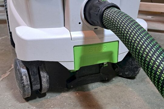

Parking Brake
A foot-activated brake raises the front casters, stabilizing the unit. On rough surfaces, it’s incredibly effective. On smooth floors like my concrete shop, it still performs better than typical caster locks — though some sliding can occur with strong hose tugs.
Foot activated parking brake lifts front wheels off the floor

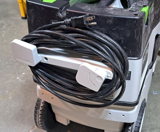

Power Cord Storage
A 25-foot, 12-gauge power cord offers excellent reach. A rear-mounted cord hook and side clips keep everything neatly stowed when not in use. One of the side clips rotates to make cord removal quick and easy — a thoughtful touch.
A long power cord that is easily stored

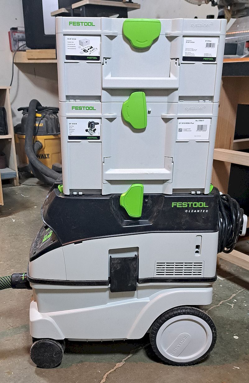

Sys-Dock Top & Systainer Compatibility
The CT 26 E I doubles as a rolling workstation. The flat top includes a Sys Dock system for securely latching Festool Systainers — modular storage boxes ideal for tools, accessories, or hardware. Two green locking handles (T-LOCs) make the connection effortless. Even non-Festool users can buy Systainers separately to take advantage of this system.
Stack as many Systainers on top of the CT26 as you want

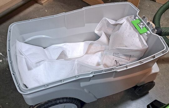

Self-Cleaning Dust Bags
The CT 26 E I includes a SELFCLEAN dust bag that resists clogging by collapsing slightly when the motor shuts off — causing fine dust to fall away from the inner surface, reducing caking. A built-in rubber gasket prevents dust leaks. The bags fill to the brim evenly without any apparent loss of suction power.

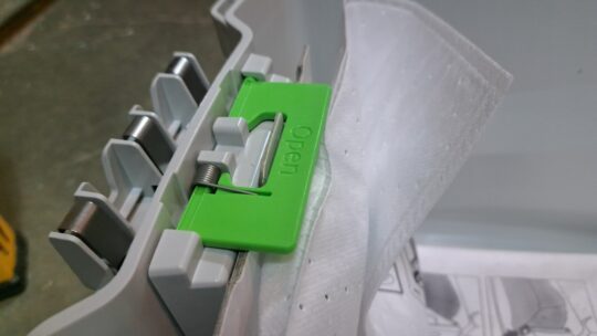

Changing a bag takes less than a minute. A 5-pack (#496187) costs $67. Alternatively, Festool offers a Longlife reusable bag (#496120) rated for up to 500 uses — a significant cost saving if you use your extractor on a daily basis.
Retention clip makes for easy removal of dust bag

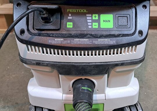

Motor and Power Control
The motor draws 10 amps, delivering 138 CFM and 96″ of water lift — enough for nearly any small or medium tool. The front control panel includes a tool-triggered auto-start outlet, adjustable (5-step) suction control, Bluetooth connection button, and manual power switch. Plug in a tool, and the extractor powers on automatically with soft-start protection. The suction dial lets you reduce airflow — I use it to lower air suction when finish sanding — and as a bonus it decreases noise in the shop.
Festool CT 26 EI
Straightforward up-front controls: auto start outlet, Bluetooth connectivity, variable suction control and power switch
Auto Start Features
One of its most useful capabilities is the tool-triggered auto-start, which powers the extractor on when a connected tool is activated. You can use tools that draw up to 2,400 watts (20 amps). Thanks to its built-in Bluetooth module, it can also be started wirelessly using compatible cordless tools or a remote on the suction hose — making it extremely convenient when working away from the unit.
