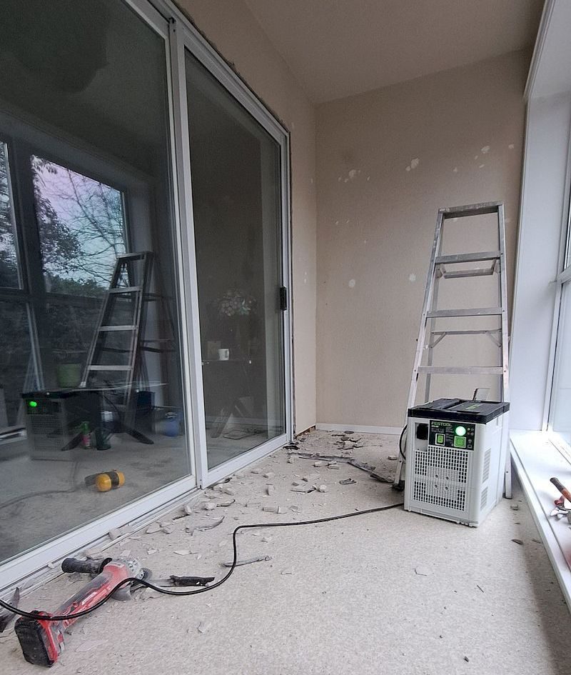

I also used the SYS-AIR during a project removing a sliding door from a 75-square-foot (600-cubic-foot) sunroom. Part of the job involved using an angle grinder to cut the flange through a 1-inch-thick layer of stucco. Within 10 minutes, the room filled with a thick fog of fine cement dust. The SYS-AIR completely cleared the air in just under 15 minutes to the point where we could safely remove our respirators, proving invaluable for indoor demolition work.
