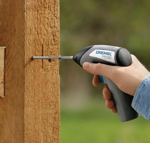

The compact size of these tools makes it possible to work in tight spaces where other tools simply can’t go. There are two main handle styles: pistol grip (B&D LI3000 and VPX, Bosch, Dremel, King, Skil, Triton) and barrel type (Craftsman, DeWalt, Hitachi, Makita, and Milwaukee). The pistol grip, which resembles its larger drill/driver cousins, is naturally a little smaller in size and makes a much better fit for smaller hands. The barrel style is long and cylindrical. This allows it to reach into deep narrow openings when required, but the added length can be a hindrance in other situations. To overcome this, these units have a knuckle in the center, which allows them to be folded into a pistol grip when a shorter profile is needed. The addition of a collet lock makes it possible to use some of these to finish driving a screw the last little bit by hand.
As with all tools, ergonomics are important. Some of these, like the Dremel and Triton have a comfortable fit for smaller hands, while others, like the Bosch and DeWalt are larger and more robust and would fit more comfortably in a larger hand: try them out before you buy to find one with a comfortable fit for your hand.

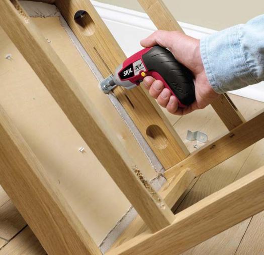

These small powered screwdrivers really shine when you have multiple screws to drive. Installing a kitchen full of drawer slides and door and drawer pulls with a manual screwdriver can leave your wrist numb and aching; using one of these can lessen the risk of a repetitive strain injury in this type of situation. People with arthritis and joint problems will find these little tools especially handy for routine work around the house. The compact size of these make it easy to drive screws in hard to reach areas where it would be difficult to start and drive a screw with a larger drill or a manual driver, such as when installing drawer slides in a cavity. If you have a young woodworker that likes to visit you in the shop, these screwdrivers are a great gift. Imagine their thrill when they can have a real cordless drill, just like dad.
