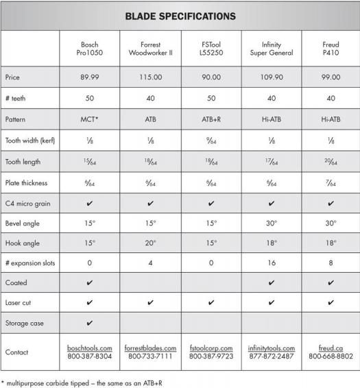

To make selecting a combo blade less onerous for you, we put five commonly available blades to the test. The Bosch and FSTool blades have an ATB+R tooth arrangement, with teeth in groups of five, separated by a deep gullet. Both use a standard 15º tooth bevel and hook angle. The Freud and Infinity employ Hi-ATB with a 30º tooth bevel and 18º hook angle. The Forrest ATB blade fits somewhere in the middle with a 15º tooth bevel and 20º hook angle. The Freud plate was 1⁄64″ narrower than the teeth width, while the other plates were a standard 6⁄64″ wide.
All these blades have thick C4 micro grain carbide teeth, and were laser cut. Except for the FSTool, which was 1⁄64″ thicker, all the blades were a standard ⅛” thick. Tooth length varied from 15⁄64″ on the Bosch to 20⁄64″ on the Freud. Three of these blades were coated (Bosch, Freud and Infinity). Neither the Bosch or FSTool have expansion slots, while the Infinity has a whopping 16. Only the Bosch came with a storage case, which serves to protect the blade when not in use and when sent out for re-sharpening. We inspected the blades visually, and all appeared to be well made with clean laser-cut bodies and expansion slots. The teeth grinding looked accurate and consistent, and the brazing clean and regular. The arbour holes were precisely cut, as all the blades fit snugly on the arbour with no discernable slop.

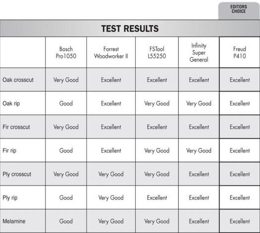

The only way to tell how well a blade performs is to use it. We tested the blades on a SawStop contractor saw, which has a 1 ¾ HP motor wired for 220V. Before testing we checked the saw to ensure that the rip fence and miter fence were properly aligned and that there was no discernable arbour run out. The tail end of our rip fence is slightly toed out – the width of a couple of sheets of paper. We didn’t use a zero-clearance insert (ZCI) when cutting the sheet goods, as the SawStop has a throat plate that has a very narrow blade clearance. However, if you have a standard throat plate on your saw we highly recommend that you make and use a ZCI when cutting sheet stock, or when ripping very narrow solid stock (see “Shopjig: Zero Clearance Insert”, Feb/Mar ‘08, Issue #52.) We hand fed the stock as fast as the saw could handle it without taxing the saw. In our test we made each of the same cuts five times, selecting the final cut to examine. We opted to test the blades on 2″ oak and fir, and ¾” birch plywood and ¾” melamine, four common shop materials.
We decided to rate the cuts in solid wood as follows: Excellent – minimal or no blade marks, leaving a silky smooth surface; Very Good – blade marks that would require very light sanding or hand planing to remove, or a quick pass with a card scraper, but still a very smooth surface; Good – blade marks that would require somewhat heavier sanding or planing, with a noticeably rougher feeling; Poor – a rough surface that would require a cleaning pass on the jointer.
For the sheet goods, our rating consisted of: Excellent – no tear-out on the top or bottom sides; Very Good – no tear-out on the top side and minimal tear-out on the bottom side; Good – minimal tear-out on the top or bottom sides; Poor – an unacceptable cut on top and bottom.
The Freud blade was clearly the most impressive blade in the group. It performed flawlessly on every cut, producing mirror like surfaces. And at just under $100 it gives great value for your money. It is no surprise that the Infinity fared almost as well as the Freud, as they have similar tooth designs. The finish left on rip cuts by the Infinity was only marginally inferior to the Freud. It’s priced a tad over the Freud, and currently there are no Canadian dealers (you can order direct from Infinity Tools). Still, this is an excellent choice. The Forrest blade performed just as good as the Freud and Infinity in all cuts except on plywood and melamine where its results were only marginally less stellar. The FSTool and Bosch blades are similar in design, with the FSTool performing somewhat better than the Bosch, particularly in crosscuts.
When interpreting these test results bear in mind their inherent limitations. Your results with any of these blades should be relatively similar to our results but don’t expect them to be exactly the same. The particular saw you are using, the material you are cutting, the length of the cut, and your comfort level are all contributing factors to the quality of the cut. Also bear in mind that the saw blade industry is very competitive. Leading manufacturers adopt the latest technologies and materials to maintain, and expand, their market share.
If you want a blade that gives exceptional results in solid stock and sheet goods, then look to the Freud or Infinity blades. If you don’t use a lot of melamine, then the Forrest blade will give just as good results. If you’re looking for a good economical blade, and can live with the occasional foray to the jointer for a bit of cleanup work, then either the FSTool or Bosch are good choices.
