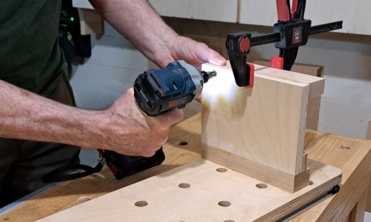

I like tools that are both light and comfortable to use. At around 3.1 pounds with battery installed, I can use  the GDR18V-215B12 for extended periods of time without undue wrist or arm discomfort. I especially appreciate this when working overhead.
The short head — roughly 5″ — makes this impact driver easy to work in tight spaces, while the 1/4″ quick-change hex chuck has a  “power groove” for better bit grip.
LED lights are common to almost all hand powered tools today, but some, like the Bosch, are better designed. The tri‑LED ring around the chuck allows for excellent illumination of the work area — much better than  LEDs mounted on the base, just above the battery housing.
