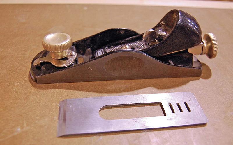

Block Plane
I suggest buying a less expensive plane and swapping the stock blade for a thicker replacement. The thicker blade will reduce chatter and the higher quality steel will maintain a better edge. A less expensive plane will require more time to flatten the sole, but you’ll have a high performance tool for half the price. I’ve been using a fully adjustable low-angle Stanley block plane with a Hock replacement blade for the last year. The plane’s adjustment mechanism requires a little more TLC than a Veritable or Lie-Nielsen, but it can cut just as well.

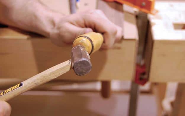

Small Hammer
A small 7 oz or 8 oz Japanese plane hammer isn’t perfect for every job, but it’s pretty good at common tasks like chopping dovetails, adjusting planes or driving small finishing nails. Once you’ve developed your skills and an understanding of the type of work you like to do, you may be inclined to buy some more specialized hammers. My only other hammer is a turned applewood mallet given to me by a friend.

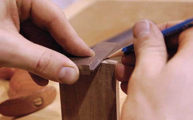

3″ Engineer’s Square
This is my tool of choice for laying out joinery. A small square is more manageable when marking a small line on a small part. If the square is much bigger than the part you are marking, it can become challenging to hold it in place to mark a clean, accurate line. You want to be confident in the accuracy of your tools, so buy the best you can afford and avoid buying used, as there is a good chance a used square has been dropped.

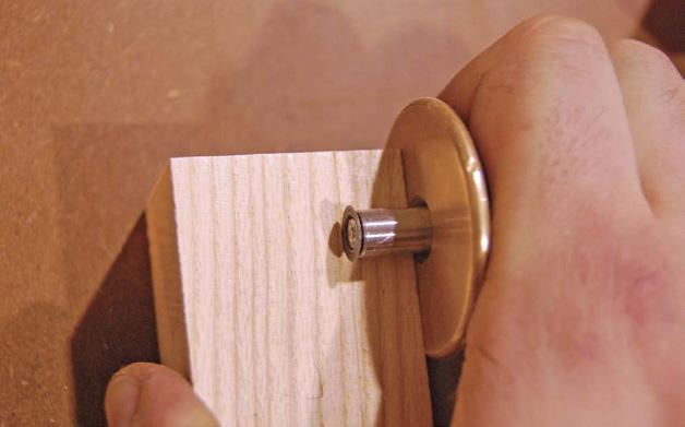

Wheel Marking Gauge
A standard wheel marking gauge will make clean, accurate reference marks. It’s also great for transferring measurements (like the depth of a mortise). They are not expensive and there’s no need to shell out the extra cash for one with all the bells and whistles.

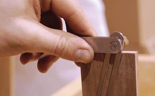

6″ Sliding Bevel Gauge
If you want to do any work with angles (and you do), then you need a sliding bevel gauge. They help you layout dovetails and let you transfer angles to and from drawings, machines, and parts. A cheap bevel gauge is harder to set accurately and will inevitably loosen up when you need it most, so this is another tool worth spending a little extra on.

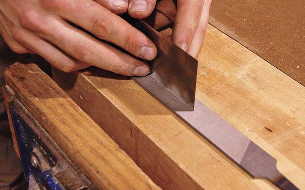

Mill-Bastard File
Files are extremely useful, helping to shape parts, sharpen scrapers, and round over tenons. You will inevitably collect a variety of files, but the oh-so-average “mill-bastard” is a good place to start. The “mill” refers to its shape and single-cut parallel rows of teeth, while the “bastard” means the cut is between rough and smooth.
