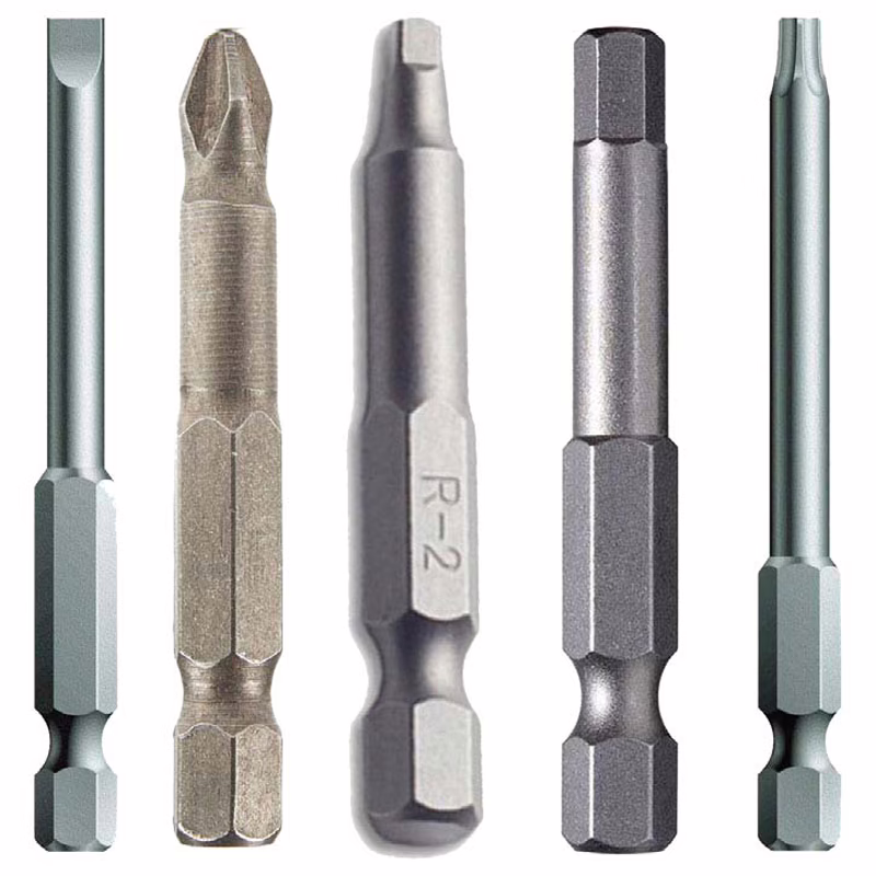

A driver bit, also called a screw bit, is used to fasten screws and sometimes nuts and bolts. Screws come in various head styles, including slotted (flathead), Phillips, Robertson (square), hex and Torx. Driver bits are designed to match these screw-head styles and are available in different lengths to suit various tasks. Made from hardened steel to withstand high torque, driver bits are often used with bit holders for better control and convenience. Driver bits generally have hex shanks.

Left to right: Slotted, Phillips, Robertson, hex and Torx
Notice how driver bits all have hex shanks. These shanks fit nicely into either a bit holder that’s chucked into the jaws of a drill / driver or directly into a hex chuck of a drill / driver.
driver bits
