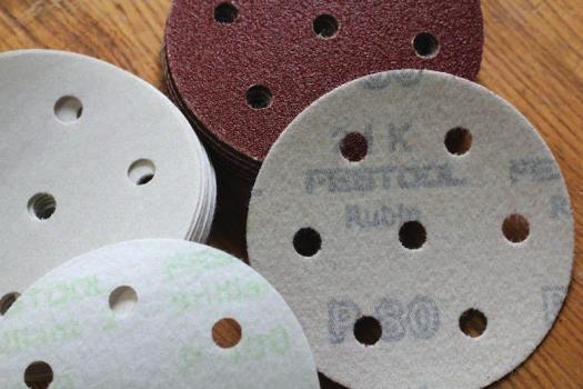

Woodworkers use sandpaper in different formats: sheets, discs, belts, rolls, and pads. Discs are available in two styles for attaching to the backing pad on a power sander. PSA (Pressure Sensitive Adhesive) discs use an adhesive while hook & loop discs use a Velcro system. Hook & loop discs are far quicker and easier to use. Sponges, made with open-coat aluminumoxide grit, come in various shapes, and are ideal for sanding curved work, profiles, and intricate shapes.

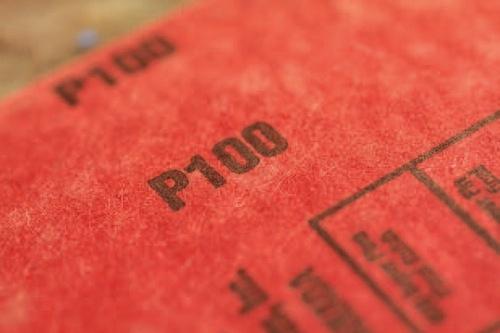

Sandpaper is classified primarily by the type of grit and the size of the grit. There are two common standards for classifying grit sizes – UAMA (United Abrasive Manufacturers Association) and FEPA (Federation of European Producers of Abrasives). UAMA graded sandpaper is printed with the grit size number on the backing, FEPA with a ‘P’ preceding the grit size (on the backing and sometimes just on the packaging). Sandpaper made in Europe confirms to the FEPA standard. Up to about 220-grit the two classification systems are very similar, otherwise they are not at all comparable. For example, FEPA P1500-grit is approximately equivalent to UAMA 800-grit.
The sequence of grits used will depend on such factors as the prominence of milling marks left after jointing and thickness planing your stock, the grain pattern of the wood being used, and the type of finish that will be applied. In general though, a good place to start is with P80-grit or P100-grit to remove machine milling marks, followed by P150-grit if a film finish is to be applied, and up to P220 for an oil finish. Up to P320 on end grain and blotch-prone woods.

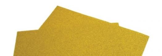

is the most widely used abrasive material. The grit comes in various grades with the better quality being more friable. As the grits break down they retain their sharpness so the sandpaper cuts quicker, doesn’t load-up as quickly, and lasts longer than most other sandpapers. In use, the grit becomes smaller in size, producing a somewhat finer scratch pattern. Grit sizes range from about 40 to 800, and it’s available in all the common formats.

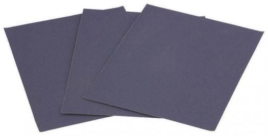

, also referred to as carborundum, is harder than AIO, but not as durable. Under pressure it tends to wear down quickly. However, it cuts more rapidly and produces a uniform scratch pattern. It also has a waterproof backing. SC is typically used in finer grits for smoothing a finish between coats and for rubbing out film finishes, where lighter sanding pressure is applied. It’s generally available in grits 220 and above, in sheet format.

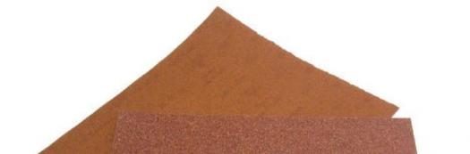

is the granddaddy of sandpaper grits. It’s a natural grit with hard, sharp edges that aren’t friable, but crumble in use, which tends to burnish the wood surface. It wears more quickly and has a greater tendency to clog up than AIO, and is bonded to a stiff paper backing that breaks easily when folded. However, it does produce a smooth finish, and is about 50% less expensive than AIO, which still makes it a popular choice among woodworkers. Garnet is typically available in sheet form up to 220-grit.

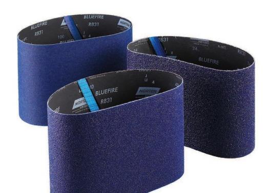

, in the form of alumina zirconia and ceramic aluminum oxide, are very tough, sharp, and long-wearing. The grit is friable, but much less so under hand pressure. More expensive than other grits, they’re generally available in belt and disc formats from 36 to 120-grit, and used primarily for power sanding.

Some manufacturers, like Festool and Bosch, have created their own line of sandpaper that works nicely with their sanders.
