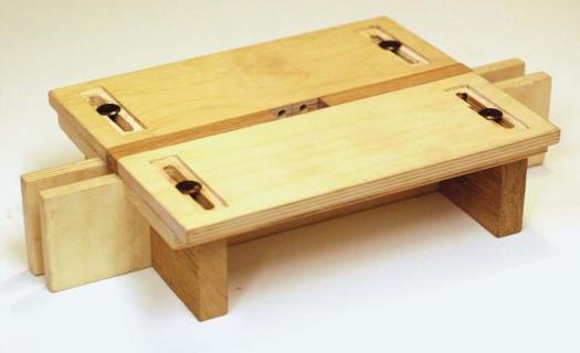

Flush Trim Jig
This is a simple jig, featured as the Shopjig project in Issue #54, it can be easily made in the shop for next to nothing. Using a spiral bit or a hinge mortising bit, this is the ideal jig to trim plugs and edge banding flush with a surface. Keep the bottom waxed to allow it to move freely.
Mortise and Tenon Jig
Another Shopjig, the mortising jig from Issue #56, can be made in the shop for very little. For a woodworker that has a limited budget this jig can be an entry into router cut mortises. It has the capability to cut very accurate mortises but it requires diligence from the user. For someone who has a more generous budget and is looking for the best mortise and tenon jig on the market, then the Leigh FMT is your tool, leighjigs.com. They have refined this jig to the point where there just is no equal. With a plunge router you can cut virtually any mortise and tenon joint you may need in furniture construction as well as cutting mortises for louvered doors.
