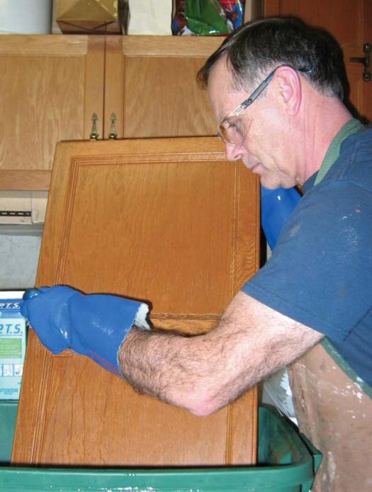

Cleaning

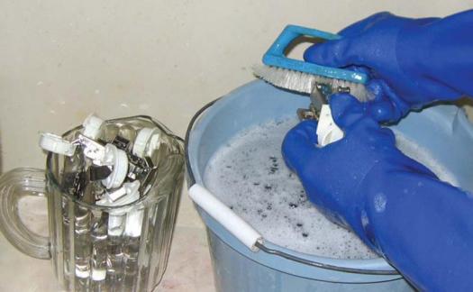

No matter how careful you have been in cleaning kitchen grime and grease off the door and drawer fronts over the years, before you attempt to apply any finish you need to do a thorough clean­ing with TSP or a similar grease-busting cleanser. Protect yourself by wearing protective gloves, safety glasses and an apron (your shop apron will do just fine and will keep you out of hot water with your significant other if you use one of those nice, clean ones from ‘their’ kitchen). Place the doors, one at a time, in the laundry tub or a plastic tub and sparingly apply the cleanser with a bristle scrub brush. Using a circular motion, go over the entire area, working from the top to the bottom. Dip the brush into fresh cleanser. Once both sides and all edges have been done, rinse them off with fresh water – again, sparingly. Remember, the objective is to remove all grease and grime while not causing any delaminating or swelling of wood with excess water or cleanser. Stand the doors against the wall of your shop to thoroughly dry before proceeding with sanding. While you’re waiting for the doors to dry, clean the hinges, handles or knobs in the same solution, and then set them aside to dry.

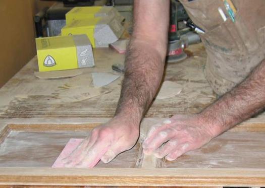

Sanding
The condition of the existing finish dictates to a certain extent exactly how much sanding is needed. If the existing finish is relatively smooth and the clean­ing didn’t cause any problems with the finish or swelling of the frame or panel, all that is needed is a light sanding by hand with 220 grit sandpaper. Use a sanding block or sanding foam pad and make sure you get into all corners. Be especially careful to sand consistently; taking too much from any one area will show up as a much lighter tone when the finish is reapplied. You will notice that my doors required a more complete sanding, as the frames were quite badly worn and in need of more aggressive sanding.

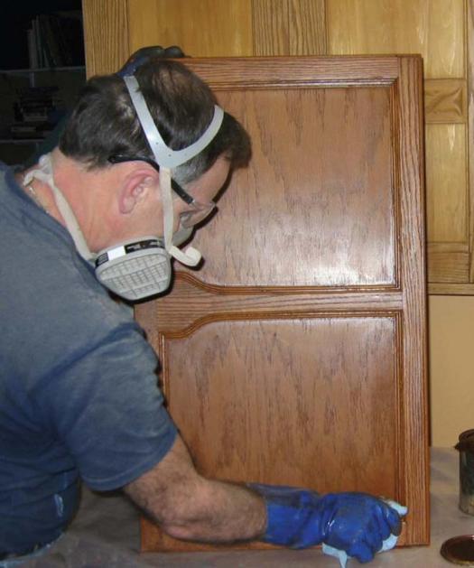

Staining
If your doors and drawer fronts are stained and you are satisfied with their colour or tone, you can move right along to the next step. If, however, the stain appears to be inconsistent in tone, either as a result of years of wear and tear or the cleaning or sanding you just finished, you may wish to apply a light coat of stain to even things out. Before going ahead with this staining, perform a test on the inside of one of your less conspicuous doors. The technique is to apply a light coat of stain by brush, then wait approximately one minute before wiping it down with a dry, lint-free rag. If you find the tone is too light after this, completely wipe off the fresh stain using whatever solvent is appropriate for the stain and allow the area to dry before trying a second time. If you’re in a hurry, do your test on another incon­spicuous door, this time allowing more time for the stain to set before wiping it down. Once you are satisfied with the colour and tone, tackle all doors and drawer fronts before moving on to the next step.

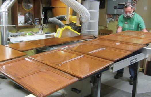

Applying the Protective Topcoat
Give yourself plenty of time – four days is about right – if you are applying the topcoats by hand. The process is the same as for any single piece of furni­ture or woodworking project: apply coats thinly and allow each coat to dry fully before lightly sanding between coats. You will likely require three coats to do the job properly. Alternatively, depend­ing on the amount of space you have in your shop, your enthusiasm and time available to apply the protective topcoats, you may wish to consider having this last finishing step done by a professional finisher. In my case I sprayed waterborne lacquer on the doors and drawer fronts, which took slightly more than half a day with the help of an associate.

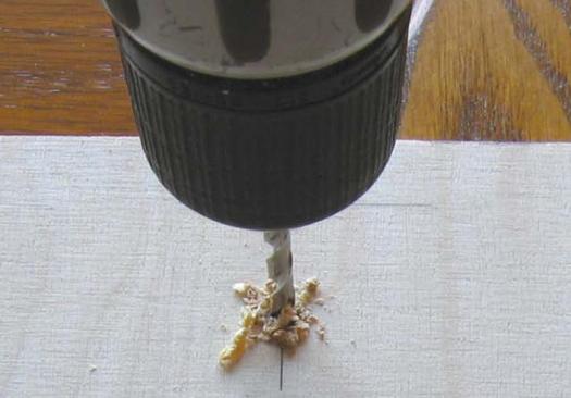

The hardware is the next item for you to focus upon. If you have to drill new holes for handles or knobs, do so now. Carefully measure where you need to drill, as it’s not much fun to have to fill and refinish an incorrectly drilled hole. Incidentally, if you look carefully you’ll see the filled hole from the old handles. Fortunately, the new handles were lon­ger, which made the old filled holes very inconspicuous when the job was done. If you are applying handles, after drill­ing the first hole, use a simple shop-made jig to locate the second hole. Once your handle or pull holes are out of the way, mount the hinges to the doors.

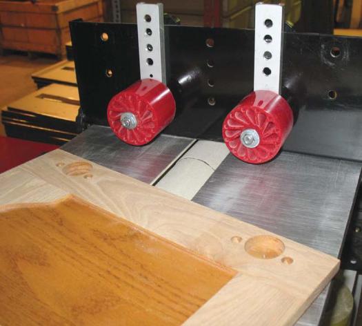

Efficient Option
There is a sanding tool out there that can make short work of sand­ing your old cabinet doors. The ‘V’ Drum Sander from Stockroom Supply is an innovative drum sander that works extremely well for most sanding tasks. With one pass over this drum sander, you will remove all finish and stain so you can proceed with refinishing. For detailed information and vid­eos on the ‘V’ Drum Sander, visit stockroomsupply.com.

Thorough cleaning
 Using TSP, give all the cabinetry a good scrubbing to remove all the dirt and grime.
Don't forget the hardware
 If you are reusing the hinges, give them a good cleaning so that they will look good with your refinished wood.
Sand away
 Pay attention to detail when you are sanding your doors and drawer fronts. You don’t want to leave any original finish behind.
Fresh color
 Apply a fresh coat of stain to breathe new life into the look of the wood.
The right finish
 Make sure that you choose a finish that will stand up to the wear and tear of a kitchen.
Simple jig
 Drill the first hole then using a screw, attach a simple drilling jig to locate and drill the second hole.
