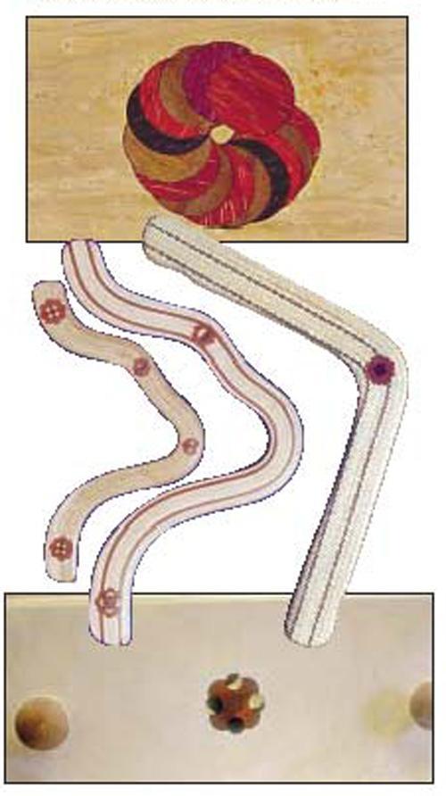

The “swirl” design, showin in the lead photo, is very easy to do and very attractive.
INLAY
Once you have decided which inlay pattern to go with, you have all your plugs ready and you have your pattern drawn on a piece of wood, then you can begin to drill your first inlaid piece (or plug) with your forstner bit. Be careful not to drill deeper than the thickness of your plug. REMEMBER it’s better to sand off than to fill in.
I used a piece of birdseye maple to inlay. It has a close grain and is quite dense so I used the thin viscosity super glue. Drill the first cavity and quickly brush the piece of padauk with sandpaper to remove natural surface oils. This ensures better adhesion. With this type of “swirl” design it isn’t necessary to draw anymore circles. Just let the forstner bit do your circle drawing and follow the circumference of the large circle.
Evenly distribute just a few drops of glue in each cavity, to secure your inlay. Press-fit your plug and then, quickly, clamp for 10 or 15 seconds.
Use walnut, or wood with a contrasting colour, for your second plug. Make a second cut partially overlapping your first inlay. Repeat this around the circle using alternating wood colours. You may wish to add an ebony inlay with every fourth inlay. Remember to clamp each inlay, or press firmly with your finger for the required time.
Once all your plugs are inlaid you may wish to go a step further and inlay the last 1” diameter plug with smaller inlays. Sand and finish for exquisite results.
