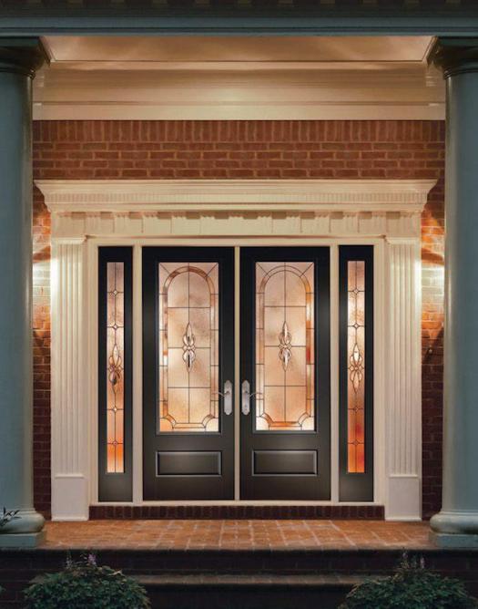

 Doors with windows, sidelights, transoms, etc., may not offer as much protection from the cold as entries with fewer windows. Glass technology has improved greatly over the years, so the differences are not as big as they once were. (Photo by Therma-Tru Doors)

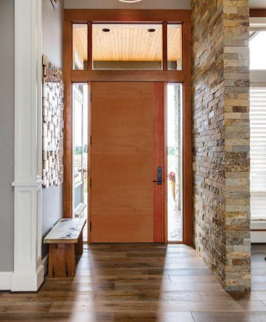

Solid wood doors can be made in many styles, especially by DIYers who want to create something truly unique. The downside to wood is that it’s harmed by the elements much quicker than steel or fibreglass, so an overhang of some sorts will go a long way to keeping them looking as new as possible. (Photo by Simpson Door Company)

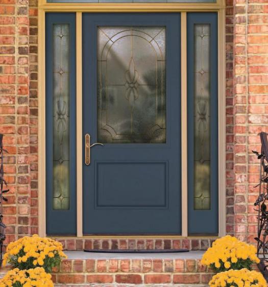

With today’s technology it can be difficult to tell the difference between a wood and fibreglass door, unless you’re right beside it. (Photo by Therma-Tru Doors)
