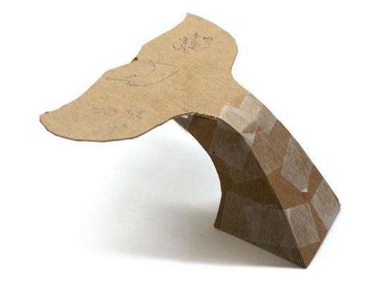

Then one night on television I saw actor Pierce Brosnan, who worked with the FSC, speaking on behalf of saving endangered whales. The connection of Brosnan to both whales and FSC sud­denly melded with my idea for a desk, and everything came together in a flash. Grabbing a pencil and a thin piece of cardboard, I scribbled out a quick rendering of what a whale’s tail would look like as it breeched. I then cut and taped the pieces together to form a scale model. This model was then scaled into working dimensions, and the building process began.

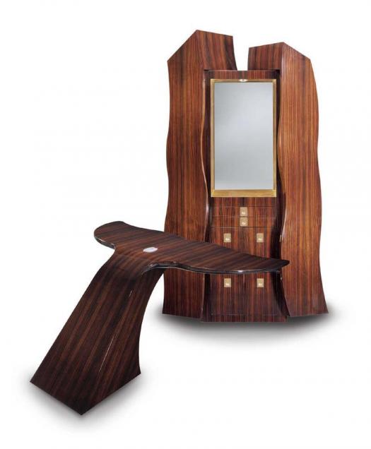

Building a Whale’s Tail
The main face of the torso and tail started as an oversized T-shaped slab of certified 1-1/4″ veneer core birch ply. Since this T-shape was larger than any available standard sizes of plywood sheet, it was necessary to butt-joint two pieces together to make the fascia por­tion of the top and lower torso.
To conceal this joint, a diagonal cross-band of maple veneer was applied between the core slab and the macas­sar ebony face veneer. After roughly cutting the basic shape to size with a jigsaw, this slab was then placed on a sliding table saw to cut relief kerfs into the underside, where the torso would bend to meet the top. The resulting offcuts from cutting the “T” to size were saved for use later to build up the apron on the leading edge of the tail. I then crafted a pair of plywood side gables from the same veneered 1-1/4″ birch plywood, and made notched tabs that would allow these sides to extend underneath the top for support. The leading edge in front of the tabs were then mitred on the sliding table saw, to align with similar mitres that were also cut on the vertical torso portion of the T-shaped slab. Rabbets were then cut into the bottom edge of the side gables to receive a 1″ thick plywood floor.
The mitres were then glued and joined on a bench, with an internal spline added for strength. While the glue was setting up the plywood floor was glued in place. Once dry, the leading edge of the tail was built up with the 1-1/4″ thick plywood off-cuts saved from earlier. The purpose of this thicker apron was to provide both strength and aesthetic symmetry to the desk. This plywood was then sculpted by hand to create a soft, tapering edge around the perimeter.
Because of the imbalance of this can­tilevered design, it was not possible to counterbalance the desk so it could sup­port itself. Therefore, the structure was engineered to be secured to the floor using lag bolts.
Loose voids and chips in the plywood edge were filled with fibreglass putty before all surfaces were sanded smooth. After a thorough sanding all exter­nal surfaces were finished in multiple layers of high gloss low-VOC polyure­thane finish to seal the grain and give a glossy, wet look, to simulate the effect of a wet whale rising from the water. The exposed edges of ply, underside of top and inside of torso were stained jet black and finish coated in black tinted polyurethane.
The finished whale tail desk was dis­played alongside a custom credenza that was also crafted from the same flitch of Macassar Ebony veneer. Both pieces have since become part of a pri­vate collection in Moscow.

As soon as Wiggers had the idea to build a desk in the form of a whale’s tail, he immediately built a cardboard and masking tape mock-up to fine-tune the design. (Photo by John Wiggers)

The desk, along with a credenza, ready for display at the Forest Leadership Forum in Atlanta, Georgia.
