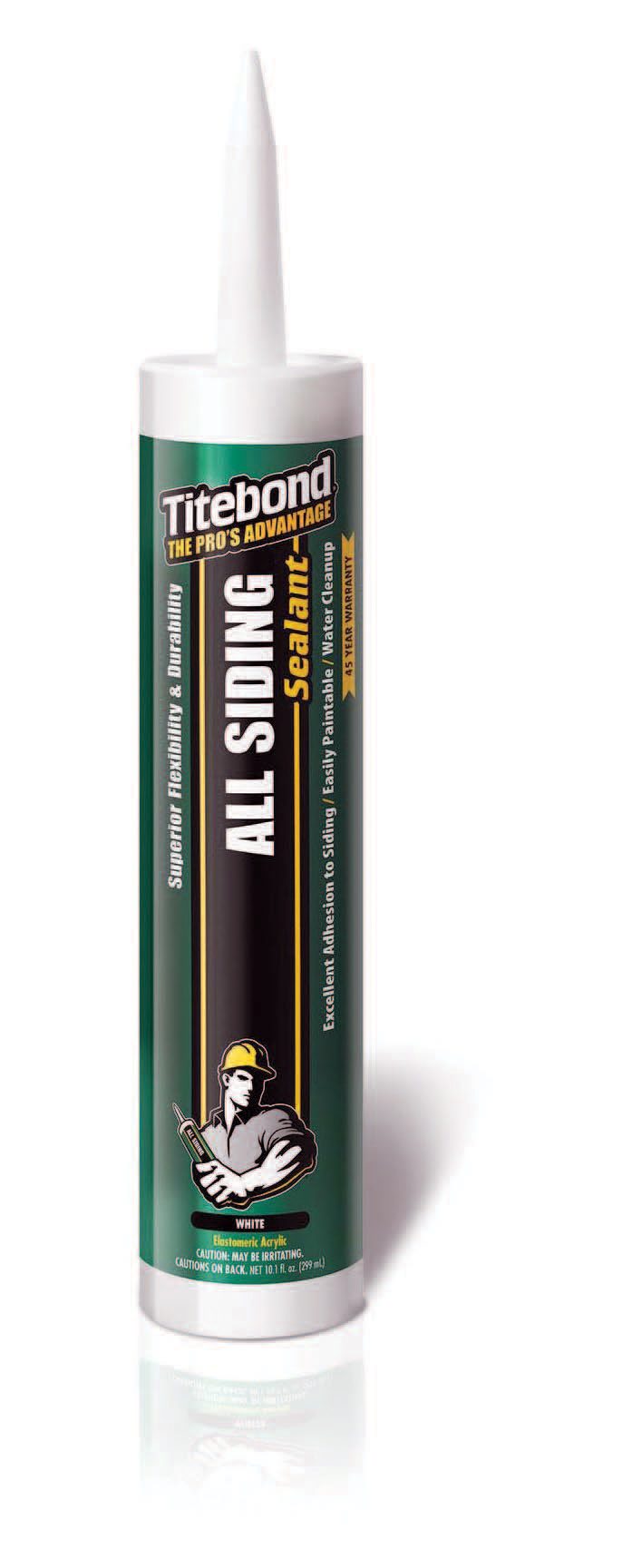

Latex with Silicone
This latex sealer with silicone is one of the many sealants from Titebond.
