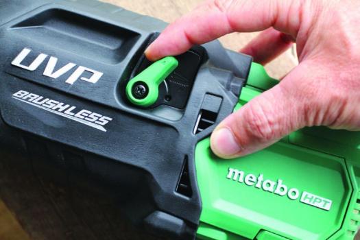

If you’re having a hard time deciding between corded or cordless options, you should consider Metabo-HPT’s CR36DAQ4. This rel­atively new offering allows users to opt for untethered 36V battery usage, or to plug the saw into an outlet with an adapter for corded usage, giving you the ultimate in flexibility. “MultiVolt” tools from Metabo-HPT are an innovative approach in how you power your tools, and will keep you going in just about any situation.

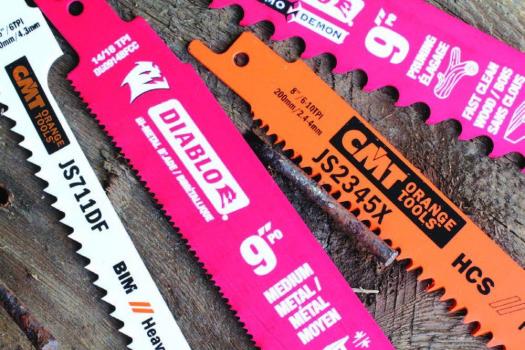

3) Battle of the Blades
You could write a separate article on blades (and luckily there is one in this issue, “Reciprocating Saw Blades”), so I will keep this short, except to highlight the importance of picking the right blade for the job. There are dozens of blade options out there, at varying lengths and for many different materials, so choosing the best blade for the job will make all the differ­ence. A brand-new saw won’t help you much if you’re using a worn-out blade that has fewer teeth than your great-grandfather.

As you start to zero in on the saw you want, there are a couple of other features to consider before the checkout, one of them being the motor. The two main options are brushed vs. brushless. Without diving too deeply into the inner workings of motors, here’s how they compare.
A brushed motor uses small brushes to make contact with and transfer electricity to the moving parts of the saw, which ulti­mately powers your tool, and in our case, causes the reciprocating motion we want. Brushes are inexpensive and this type of motor is the simpler of the two and there­fore also easier to fix as the tool ages. The flip side is that brushes wear out over time, costing you tool downtime and repair costs.
A brushless motor, on the other hand, induces an electric current, without contact, using magnets. These motors require a little more engineering to produce, and there­fore are more expensive. They’re also more costly to repair, because of their more com­plex nature. The advantage to these motors is that they are more efficient, which means they last longer, need less maintenance and are quieter.
Ultimately, a contractor using this tool regularly will probably opt for something brushless for its longevity and overall better performance. But if you’re a DIYer, there’s nothing wrong with a brushed motor and you may decide not to shell out the big bucks.

Stay Sharp
With many blade options available, it’s critical to choose the right one. Whether it’s wood, metal, plastic or another material, the right blade will make every job go easier.

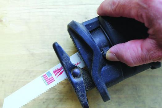

Easy Exit
All saws are different when it comes to installing and removing the blade. Some, like this Milwaukee, offer easy, quick and secure blade exchanges with the flip of a thumb lever.
