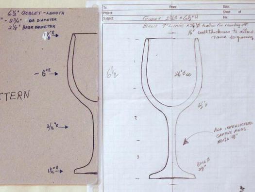

A good place to begin making a wedding goblet is by drawing rough sketches of goblets – fat ones, skinny ones, tall ones, and short ones. It is a good idea also to observe the shapes of glass and ceramic goblets and decide which design appeals to you the most. I prefer a shape that is roughly two-and-a-half to three times higher than it is in diameter, with the widest diameter of the goblet cup located about one third of the distance from the top to the base. Some say this follows a natural design principle called the ‘Golden Mean’, but I just think it looks appealing to the eye. Choosing a design is very personal; other shapes can look appealing as well.
Once you have settled on a design, draw a half-profile pattern of the goblet’s shape at the edge of a piece of stiff cardboard. You can use some other more permanent material if you want to make a number of goblets the same size and shape. Put all the dimensions and other design notes on this pattern. It’s not necessary to draw the captive rings on the pattern, just make sure the dimensions are written down so you can refer to those notes when it’s time to make them. This pattern will be used to transfer the design details to the wood blank on the lathe.

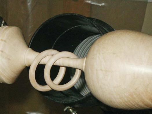

Make the Captive Rings
The captive rings are approximately 1 ⅜” o.d. x 1″ i.d. x 3/16″ thick. The 3/16″ thick captive rings will be released at the cup end of the stem. Using a 3/16″ diamond parting tool, cut two ⅜” wide grooves in the large diameter stem creating two 3/16″ wide disks. Leave a mandrel (stem) diameter of about ½”. That will be used later for sanding the inside of the rings. Carefully round off the top of the disks with a ½” spindle gouge. This forms the outside surface of the captive rings. Sand the outside part of the rings using grits from 150 through 800. This has to be done now since it is very difficult to get a good sanded finish after the ring has been released.
Using a captive ring tool, cut in from each side of both disks being careful to keep the cross section (thickness) of the ring round. As the rings are released, tape them to the bottom of the cup with masking tape. A third ring could be released if there is enough stem length.
When all the rings are released, smooth off the lower part of the stem to approximately ½” diameter to make the sanding mandrel for the inside of the rings. Place a small strip of 150 grit sanding cloth on the stem using masking tape at the edges. Make sure it is fastened so that the turning direction of the cloth tightens the hold on the cloth. Pressure sensitive adhesive (PSA) backed abrasives may be used to eliminate the need to use masking tape. Shape and sand the inside of each ring and tape each one to the base of the goblet cup. Follow this sanding, and taping routine from the base to the cup until all the rings have been sanded with all the sanding grits from 150 through 600/800. When all the rings are sanded, leave them taped to one end. This is a labour intensive part of the process but is worth the effort when you see the final results.

Author's design sketch

Captive ring taped to cup
Sanding cloth taped to stem mandrel
Stem top complete; ready to release rings
Rings released; stem and base done
