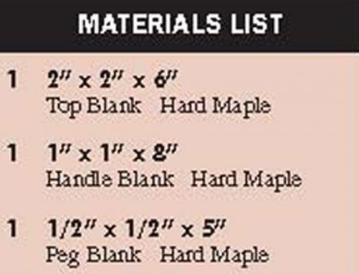

Get started by preparing a blank that is at least 6” long and 2” square. Any wood you find lying around the shop will do but dense species, like hard maple, work best. If you don’t have 2” stock in your scrap bin, laminate thinner boards together. When the blank is ready, locate and mark the centre point on each end by scribing diagonal lines from corner to corner (photo 1).

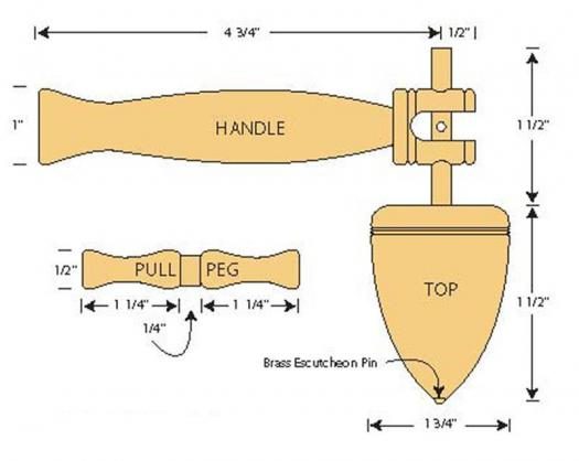

Handle and Peg
A simple handle is required to hold the stem vertical when the top is sent spinning. You can turn one on the lathe (photo 11) or use an 8” length of 1” diameter dowel as a ready-made alternative.
On the end of the handle drill a ¼” diameter hole to receive the stem and make a 1” deep slot for the windings. To prepare the slot, drill a ⅜” diameter hole at the end, then remove the remaining waste material with the bandsaw or scrollsaw. Take a look at the plans for further details. A wooden peg tied onto the end of the winding cord will allow you to get a good grip when it’s time to spin the top into action. Use a piece of ½” diameter dowel for this or make one on the lathe in no time at all (photo 12).
The overall shape and size isn’t important but a notch in the centre will prevent the string from sliding out of place.
