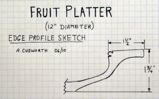

Edge & Rim Profile Sketch
 Sketching out the profile of the platter before you start leaves less room for errors down the road.

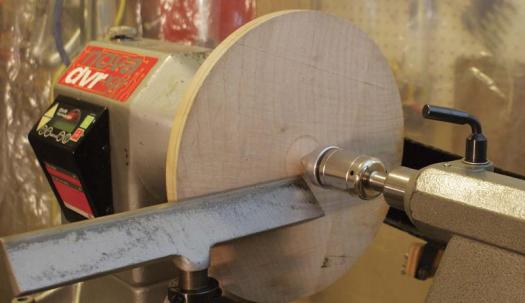

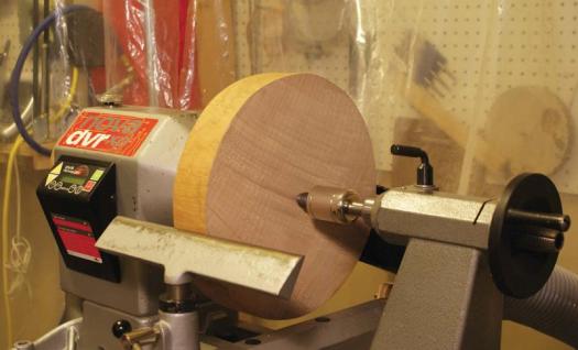

Blank Mounted Between Centers
 With the blank mounted on the lathe, bring the tailstock with the live center up to the platter to add support.

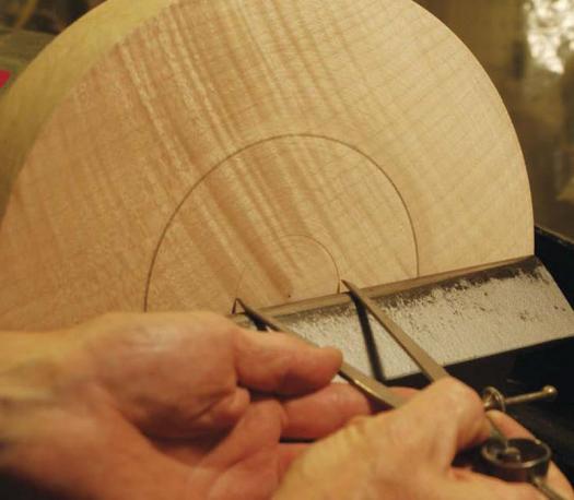

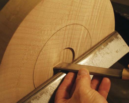

Marking the Chuck Recess
 Depending on what size recess your chuck requires, mark the dimension on the bottom of the platter.

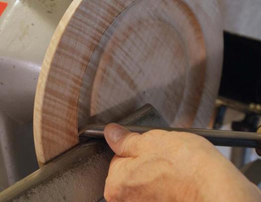

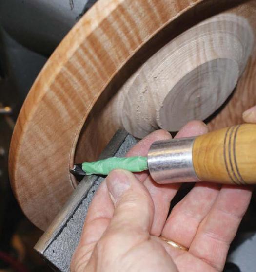

Refining the Chuck Recess Inside Edge
 Use a skew to fi ne tune the size of the recess to fit your chuck.

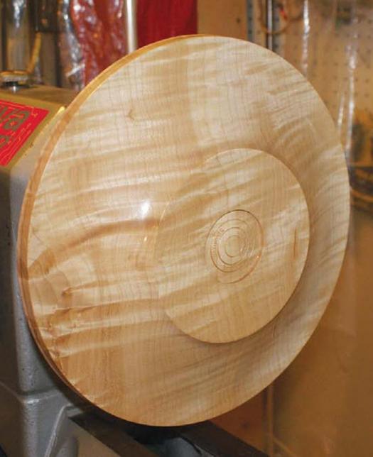

Half Way There
 With the bottom side done, the platter is half complete.

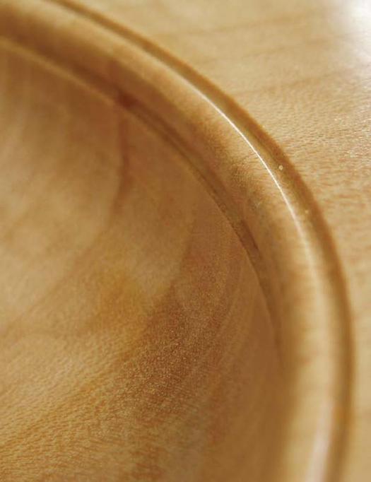

A Small Detail
 The inclusion of the bead adds a little style to the platter

Basic Design
This fruit platter will have an outside diameter of 12″ and a thickness of 1 ¾”.
The top face of the rim will be 1 ½” wide and will be enhanced with a single bead at its inside edge. I like to make a sketch of the intended rim and edge profile.
The outside/bottom profile will have a modified ogee shape extending from the outside edge of the rim tapered at the base. The outside diameter of the base will be 6″. A design rule of thumb is that the base should be approximately one-half the outside diameter of the platter. The inside profile of the “bowl” section will be curved to complement the outside shape.

Locate the center of the top side of the blank; make a dimple and drill a 5/16″ diameter x ¾” deep hole on a drill press. If you are using a hand drill, make sure the hole is perpendicular to the surface of the blank. Place the four-jaw chuck, with the 2″ (50mm) jaws installed, on the lathe spindle and clamp in the Woodworm® screw. Mount the blank on the Woodworm® screw and make sure it is tightened securely against the face of the chuck jaws. If you do not have a chuck and want to use a faceplate, center it on the face side of the blank and fasten it securely with metal screws. When using a faceplate, I use metal screws rather than wood screws since they have a steep/ sharp thread configuration that holds better. I do not use drywall screws as they are brittle and can snap off.
Bring the tailstock with the live center up for support. It is a good safety practice to keep the tailstock in place as long as possible. You will have to move it back and forth as you make the cuts.
True up the edge and bottom face of the blank with a sharp ½” bowl gouge. This reduces vibration. Mark the outside diameter of the 6″ base on the blank using a centering ruler and marking at 3″ on each side of center.
Use a set of dividers to mark the 2 ¼” outside diameter of the chuck recess at the center of the bottom surface of the blank. This fits a Supernova® four-jaw chuck with 2″ (50 mm) jaws in expansion mode. Your dimensions may be different. Make sure that the lathe is running at a slow speed and only the left point of the dividers contacts the wood or you could have a “snappy” surprise.
Shaping the Bottom
Turn the outside diameter of the platter just proud of its finished size using a ½” bowl gouge. Form the 2 ¼” diameter by 3/16″ deep chucking recess. This recess does not have to be deep. It is surprising how well a shallow recess will hold the piece provided you take light cuts. I used a Bedan scraper to cut the recess and refine its inside edge with a ¾” skew laying flat on the tool rest. You can use a 3/16″ parting tool or any appropriate scraper to make your recess. Make sure there is a small flat area at the outside edge of the bottom of the recess for the tips of the chuck jaws to seat against.
Roughly shape the bottom side of the platter with a ½” bowl gouge. Here’s where your profile drawing becomes useful. Make cuts with the grain of the wood from the center of the blank to the outside edge. Form the 6″ diameter base. The bottom of the base needs to have a slight concave shape to allow the platter to sit on a surface without rocking. Leave enough wood at the rim area to be able to form the 1 ½” wide rim. You can create a slight undercut for a finger grip in the back side of the rim, which will make the platter easier to pick up. Measure and mark the 1 ¾” overall height of the platter on the outside edge of the rim. I use two steel rulers to do this; one laying flat across the base and the other measuring across the edge.
Finish turning the bottom side of the platter. You may find it useful to use a cutting and sanding compound, or some beeswax, to soften the grain of the wood. Use a 1″ side-ground scraper to remove the tool marks if needed. Refine the inside of the recess and decorate as desired; that is, concentric rings, a slight convex dome, etc.
Sand these surfaces starting with a grit size that will remove all the tool marks and progress through the grit sizes to at least 800 so you can end up with a very smooth finish. Note that each grit size in the progression should not be more than 50 percent finer that the previous one or you will leave scratch marks.
The chuck recess will become the inside of the base and needs to be completed now since it will not be accessible for further work on the lathe unless you use a vacuum chuck. If you intend to identify or sign the piece, you should do it now so the finish will be applied over it.

If you want to leave the inside edge of the rim plain, it’s a good idea to soften the sharp edge with a little sanding cloth, but leave it crisp. However, I like to create a bead on the inside edge of the rim as a transition element from the surface of the rim to the bowl part of the platter. To do this, I created a special little scraper from a ¼” HSS jobber drill bit. I placed two of the flute points of the drill bit at a 45° angle against the surface of a grinding wheel and ground it down until the drill flute formed the shape of a small U-shaped scraper. I glued the drill bit scraper in a small handle and taped over all but the last ½” of the flutes with a few layers of masking tape. This prevented the sharp flute edges from scoring my tool rest. Some turners fill the flutes with automotive body filler instead of using the tape.
To make the bead I reduced the lathe speed to around 500 RPM and held the scraper at a sharp reverse rake angle sloping down from the inside edge of the tool rest and slowly applied it to the inside edge of the platter rim. I gently rotated the scraper around the lip until a ¼” bead was formed. I refined the little grooves with a ¾” skew and, voila, a quick bead. Be careful not to advance the scraper too quickly – tear-out or catches can occur. This bead design creates a bead that is flush with the surface of the rim and the undercut lip area. This is a good idea, since it will be harder to damage the bead during the platter’s use. I like the look of it too. This procedure works best on hard, close-grained woods. You can create the bead with a purchased beading tool, a detail gouge or a skew but this drill bit scraper works well for me, and for a few dollars you can make a whole set of different sized tools.
