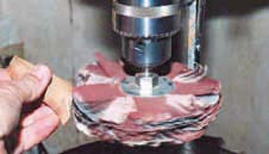

Shape with Sandstorm sander
Shape and sand with Flex Sander
Sand with Star Twister
