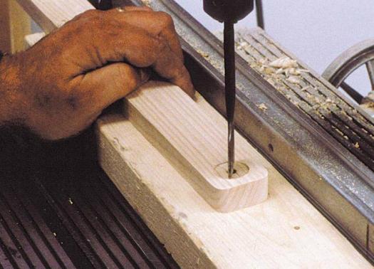

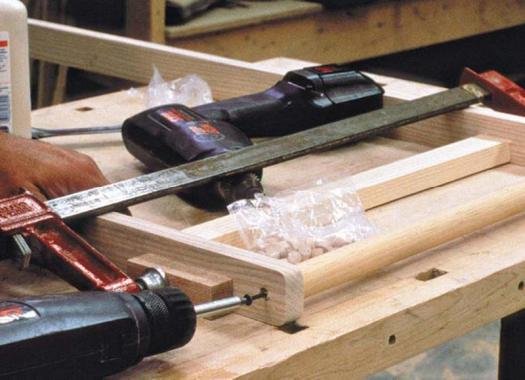

Locate a point 3/4″ from the edge and 3/4″ back of the rounded end of the side rail. Drill a hole in each side rail (1/4″ deep, 1″ diameter). Use a 1″ spade bit to drill the hole. The spade bit’s point will slightly exit the other side of the rail when you reach the 1/4″ depth. That will mark the centre of the hole.
Cut dowel rod to size. Inset the rod into the rail holes. Drill a pilot hole using the spade bit exit mark as a guide. Counterbore the pilot hole. Insert the screws, and plug the holes. Sand the wood plugs flush when the glue has dried.

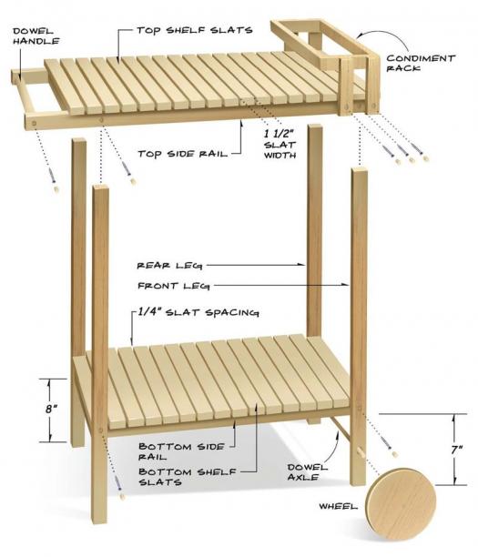

Cut the two front legs and the two rear legs. Note the different leg lengths and their position on the frame assembly. These are cut to specific lengths to accommodate the cart’s wheels.
Round over and sand smooth all edges of the legs.

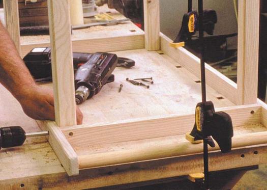

Attach the two 34″ legs inside the front cross rail. Attach the two 33″ legs inside the rear cross rail. Use 1 1/2″ long screws, glue, and wood plugs to secure the legs. Install two screws per leg, one through the side rail and the other through the cross rail into the leg. Slightly stagger the screws on the rails so they won’t hit each other when driven into the leg.

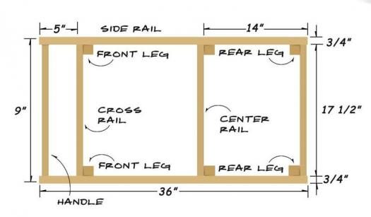

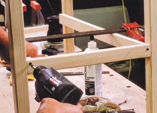

Install an additional cross rail midway between the two end rails. This centre rail will help keep the side rails parallel to each other. Install the two lower side rails to the inside of the front and back legs. That will support the lower platform.
These two rails are set back 3/4″ from the outside edge of each front and rear legs. They are 7″ up from the bottom of the rear legs and 8″ up from the bottom of the front legs.
The 3/4″ lower rail is set back to allow installation of the lower rear cross rails, between the cart legs. Cut the two rails and install.

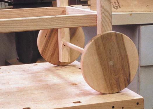

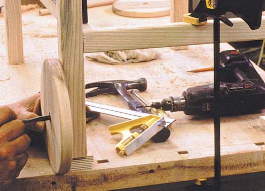

Turn two 3/4″ thick by 8″ diameter wheels on your lathe. Alternately, you can cut them out them with a band or jig saw. Drill a 5/8″ diameter hole in the centre of each wheel. Block the rear legs of the cart with a 1″ thick spacer so the cart is level on the work bench. Place the wheel in position, mark the legs, then drill a 5/8″ hole in the centre of each rear leg. Use a 5/8″ spade bit to mark the centre of the hole on the rear legs. The flanges of the bit, through the hole in the wheel, will force the drill bit’s point to centre.
Enlarge the holes in the rear legs with a wood rasp. You’ll want your piece of dowel to act as an axle for the wheels, and to turn freely.
Apply polyurethane glue to the holes in the wheels and press them onto each end of the dowel rod. The moisture cured polyurethane glue will expand and lock the wheels securely to the dowel.

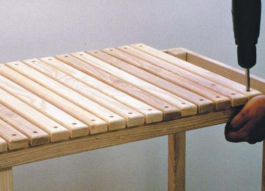

Prepare 15 pieces to be used as top shelf slats. Sand and round over the top surface with a 1/4″ round over bit. Three additional pieces are needed to complete the top shelf. They are 1 1/2″ shorter, so we can install the condiment rack.
Install the slats with a 1/4″ space between them. Start with a 1/4″ overhang on the front cross rail. The 15 slats overhang the side rails equally on both sides.
The 19″ rails are installed flush with the outside surface of the side rails. Use 1 1/2″ screws to secure the slats, one per side. Counterbore the holes and install tapered wood plugs.
The bottom shelf slats are installed in the same manner. Cut 14 boards to be used as top shelf slats. Cut two additional slats at 14 5/8″ long. These will be installed between the legs as the first and last board for the shelf. The spacing between the slats is approximately 1/4″. Lay all the boards in place and verify your spacing before securing them to the bottom rail. Plug all screw holes and sand them flush.

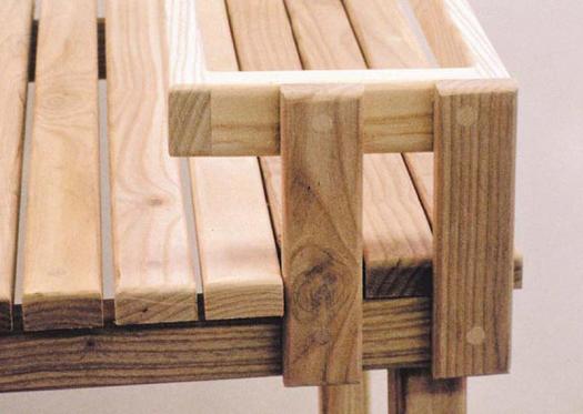

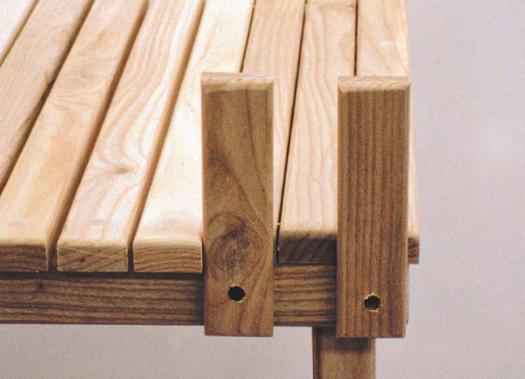

The condiment rack is simply four pieces of 3/4″ thick by 1 1/2″ wide by 6″ long stock. They are installed vertically, two per side.
The horizontal frame, supported by the four vertical boards, consists of two long boards and two shorter ones. Assemble, round over the inside and outside surfaces and attach.

With spade bit, mark hole centres on side rail
Inset rod into rail holes

Block rear legs wih 1” spacer and mark legs

Condiment rack is supported by four pieces of vertical stock
Horizontal frame consists of 2 long and 2 short boards
