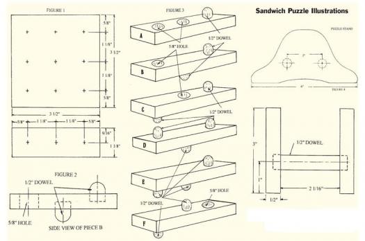

The object of the sandwich puzzle is to assemble the 6 inside pieces so that they fit neatly between the 2 outside pieces.

  • Cut out the sides and inside pieces.
  • Lay out the hole and dowel centres (Fig.1).
  • Drill 5/8” holes through the nine centres of the outside pieces. Drill the 5/8” holes through the inside pieces (Fig. 2).
  • Drill 1/2” holes half way through the inside pieces to fit the 1/2” dowels – A Forstener bit makes a nice job of these holes because it makes a hole with a flat bottom.
  • Cut out the dowels and glue them into place (Fig. 3).
  • Cut out the puzzle stand.
  • Glue the dowels (Fig. 4).
